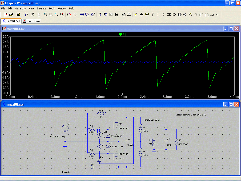

I think that much of the frequent destructions of this kind of oscillator are due to core saturation or excessive loading, or both. It enters an alternative oscillation mode that draws much more current and destroys the transistors. Actually, it's so easy to change to this mode that I would not consider this circuit for any purpose requiring a minimum of reliability.

Antonio wrote ...
What do you mean alternative oscillation mode?.... What happens to the waveform, and what would happen if you used a semiconductor that can handle that sort of load?

Antonio
Mon Aug 29 2011, 08:00PM
Location: Brazil
Inducktion wrote ...
Antonio wrote ...
This is a simulation of a typical ZVS, showing what happens with the input current if the choke inductance is reduced below a certain critical value. In this case it works correctly with 67 uH, but enters a destructive mode with 66 uH:
