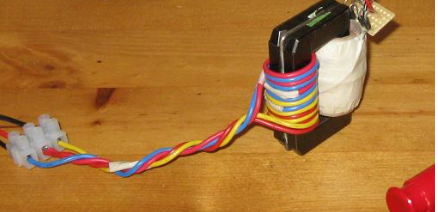

Hi all, acetone soaking worked great, so i made my own transformer this afternoon:
-I made a 4+4 primary. The secondary is approximately 240 turns.
- the results are: The sparks are less than a centimeter long, but the thick copper wire I use to make sparks turns red within 2 seconds. I haven't tried to charge a capacitor yet as the current is still unrectified. So i think it's a success.

i have yet to have the acetone eat through wire enamel (or even the tape on E-core transformers.) if you're charging caps to ~300 volts then a large spark is not what you're after. you want a tiny, very hot spark, as that would indicate a lower voltage, but a lot of current. 240turns/4 turns =60, 60x12v=720v (i know this math doesn't work for this topology but it gives a ballpark estimate)
i would double your primary turns before you charge anything. and build your own rectifier out of fast diodes instead of using a full bridge chip.
