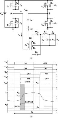

Ash Small
Sun Aug 07 2011, 10:08PM
Posts: 4245
Tom Williamson wrote ...
whats a soft switching topology?
Something like this (There are other designs)
1312754909 3414 FT121661 Soft Switched Full Bridge
EDIT: basically, once the capacitor is fully charged, current stops flowing, so you can switch off at zero volts, or 'near' zero volts (ZVS), I think. (I've done some rough calculations, but I don't trust my maths, as I'm a 'newbie'. I came up with 800nF and 50uH, for 5kW @ 25kHz and 340V, using Wikipedia's definition of a Farad, but I doubt this is correct. (My maths, not the definition))
Dr. ISOTOP
Mon Aug 08 2011, 02:37AM
Dr. ISOTOP Registered Member #2919 Joined: Fri Jun 11 2010, 06:30PM
Location: Cambridge, MA
Posts: 652
The simplest one is a series resonant transformer, where a series capacitor on the primary side resonates with the leakage inductance of the transformer.
Ash Small
Mon Aug 08 2011, 10:02AM
Posts: 4245
bwang wrote ...
Correct me if I'm mistaken, but won't the leakage inductance vary with load? A multi-purpose power supply will, at least, require a series inductor as well, and maybe even a more complex design?
EDIT: I've done some research and it seems the leakage inductance remains constant.
