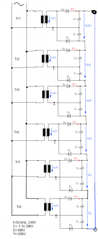

I will insert my Setup into oil. It isolates up to 12kV/mm.
btw. on the attachment you can see my setup.

well, idea is same as mine right now, just i will use one primary and 7x20KV transformers on single core, and will have at least 240kV insulation between core and windings and around 120kv between core and primary.
just a heads up, you will have high voltage difference between primary and secondary, if you use 6 transformer in parallel, and if that is FBT from TV, it will be killed instantly

No I won't use flybacks.
I've got parts and the schematic from an other x-ray device.
So all these parts were used togeter in a C-arm for 110 kV 10mA continuously.
Those transformera have layer-insulation and are inserted in oil too

I think that parallel diodes aren't quite a good idea (because of the tolerances)
If one diode gets warm/hot (and this will happen) then you'll get a kind of avalanche-effect or chain-reaction.
If you're wnat to be on the safer side, use higer current approx. 40mA (Anode current) rated diodes.
If you're "crazy" build a vacuum-tube rectifier. But it will bring some problems cheesey...

well, i need at lest 10x in parallel to stand continuous current, and because it's full wave rectifier, 20mA output give just 10mA on string, mean that diodes will operate at 50% max average power, and one string can stand 10x rated power for shot amount of time.
where is no way any diode will get hot, not even warm.
idea right now use 16 in parallel, that will give peak power 5x more than single 40mA diode from ebay
and just 20% CW rated power

It doesn't matter how many you //. The one with the lowest forward voltage will explode, then the next one will explode... and the next...
...until there are no more diodes.
exactly.
The forward current of a single diode has to be even or greater than the anode/tube current...
