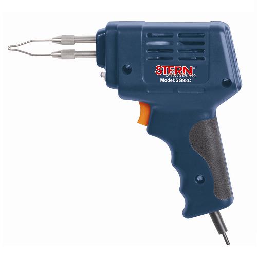

To clarify, you shouldn't use a high voltage to generate a hot arc, because it lacks precision, not to mention damage on components you want to solder.
On the other hand the correct approach is to generate a very low voltage (eg. 2V) but at a few amps, and use it to heat a tick piece of wire. We had such "soldering guns" , using a 100W transformer instead of the ZVS inverter approach you mentioned. They look like this: Link2
The high current heats the the soldering tip, made of a loop of copper wire.
Using ZVS things are easy. Build a royer oscillator and use a small ferrite core (you don't need a lot of power), with a 5+5 primary, and a few turns tick wire secondary. No rectification needed, simply short-circuit the secondary with a loop of thinner cooper wire.
Here's something similar that I built, to give you an idea: Link2 It is a high current ZVS inverter. Replace the TV Flyback with a custom made secondary of just a few turns.
This would be called : Inverter based soldering station cheesey
