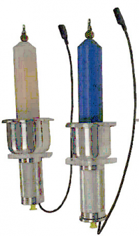

ok, here is a pic of the wanted device,
1292996239 2431 FT0 Pvms
In the above pic, the aluminum turned handle houses the low voltage R and C, and compensation components.
I suspect there is nothing in the blue/clear nylon tube but the HV resistors and at the very tip of the HV resistor a single round plate which acts as acapacitor between itself and the grounded handle. I dont think threre is a shield in the clear/blue tube. But the aluminum handle would act as a static, RFI, EMI shield for the LV section.
Also, the clear/blue part is filled with Shell Diala oil.

I am trying to figure out how they put it all together, and if we on the forum can make our own to replace the aging P6015A/B tek ones. I already have the HV resistors and will make an attempt soon, please and comments if you have anything usefull to add.

Seems okay, the LV arm capacitance seems on the order of 10 pf ... making the HV arm capacitance 10 fF which with plate capacitor calculations gets near the dimensions of the probe within an order of magnitude or so.
With 20 cm separation it's also a Faraday cage up to 1.5 GHz, so that should be enough.
I guess I grossly overestimated the amount of capacitance necessary in very high voltage dividers in your thread in the project forums, as well as shielding.

The capacitance ch is not due to the tip only, but a distributed effect along all the high-voltage resistors. The tip shape was dimensioned so it does not produce corona when properly connected to a HV conductor within the voltage range of the probe. See the probes for higher voltages in the manual cover to see how to avoid corona.

You can't have both a near full length shield on the order of 10 cm, a radius on the order of a couple of cm AND a total capacitance of a couple pF.
The shield alone would be pF range ... and the LV arm capacitance has to be 1000x as much (and determines the capacitance of the probe).
If it's not an effective RF shield, so be it ... there is no alternative.

Well, if you look in the manual, you'll see that the input capacitance is 10-15pF. That's huge by HV probe standards, it suggests that inside the tube is simply a series string of resistors with a capacitor across each, swamping the electrostatic capacitances by brute force.
I also notice that the probes have a 4 meter lead made of regular 50 ohm coax, which also shows that they didn't really care about achieving low input capacitance. (You need more input capacitance to drive the cable capacitance, which adds to the low arm of the capacitive divider, and is of the order of 100-200pF per meter.)
All in all this is probably a realistic design for a hobbyist to copy. I remember Dan McCauley/EasternVoltageResearch made something like it.

Ugh, you're right ... I thought the capacitance was from the point of view of the scope, but it's from the load of course ... the LV arm will have nF range capacitance. So back to needing distributed capacitance ... the problem with distributed capacitance with discrete components is the amount of inductance in the leads ... that's going to sing if you don't damp it.

Come to think of it, I don't think there are any resistors in that transparent bit ... just a conductor. I think it's just an air gap from the tip to the grounded base. The actual divider is probably inside the base (which could then act as a Faraday cage). 40 kV isn't that much, plenty of room for insulation there.

But as to Pinky's straight wire no resistor in the tube comment, im worried when i place a shield that close to a resistor i get 14pF ...at least. i think seperation from the ground and shield is how they get such low input C. so i think the resistors are in that plastic blue or clear part.
Also i belive there is a circle of metal connected to the HV tip, which equalizes the field distribution, between that internal circle and the curved lip of that ground cup. So internally it looks like their bigger 100+kV ones, but since its under oil and plastic, we dont get to see it.

The PVM-3 is $2400 with a typical 5 - 6 week lead time. We have a
resistor shrouded by a coaxial capacitor and the combination of the
high side of the capacitor and the grounded "Bell" on the bottom
shield stray fields. The capacitance between the resistor and
capacitor is compensated by an RC network. We also offer the PVM-1
with 2000:1 attenuation, at $1850.
As from my contact at NorthStar.
A Drawing based on an interpretation from the above...
