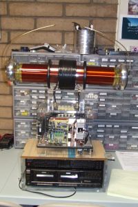

Marko
Mon Feb 12 2007, 08:52PM
Location: Zadar, Croatia
Posts: 3145
It's simply so perfect.. I had little to say about it.
Audiomodulation by frequency shifting seems hard on FET's since they go out of soft switching. This can ofcourse be solved with external diodes.
If you want to experiment (you would be the very first to do that on such bi coil) you could try to use a modulated buck/buck/boost converter/class D amp to modulate the supply rails directly.. I guess only imagination limits you there. smile

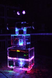

Avalanche
Mon Feb 12 2007, 09:12PM
Avalanche Registered Member #103 Joined: Thu Feb 09 2006, 08:16PM
Location: Derby, UK
Posts: 845
wrote ...
Definitely the way forward for serious sstc audio modulation - a few months ago when I was playing around with making my own inverter it turned into an audio modulated power supply for that purpose. I wasn't going to mention anything about it until I got it beyond the breadboard and to the 'impressive' stage, but that never happened. I think it was more impressive with a function generator hooked up, to produce insanely loud triangle waves. Maybe one day I'll get it running again and revive the project thread!
ragnar
Tue Feb 13 2007, 01:24AM
Posts: 1425
You wouldn't be the first to modulate the rails -- even for my really old audio-modulated current-fed push/pull flyback mess, I used a FET, source-follower, for audio modulation. I also used it on my very first ever coil, but quickly learned that I didn't have any heatsinks big enough. wink
The great thing about a pulse-width modulator supply is it can serve two purposes; A) to step down the voltage from the mains, if you're running a resonant switching topology (e.g. class-E amplifier, where voltage across the MOSFET is equal to pi * Vin, MINIMUM) and B) of course, proper rail modulation for audio.
