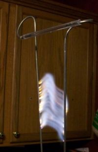

Decided to take a note from Grenadier and make a Jacob's Ladder with one of my big NST's...I now have a nearly 4' tall ladder with a 4" spread at the top...and the arcs jump right off the top!
Now I just have to figure out a way to secure the top section so it wont start bouncing in and out...it eventually settles into a rhythm that keeps it 'clapping'...

Looks good. Notice how the wires start moving. That's because there's 450W flowing through them, and they become magnets and attract each other. The same thing happens with aluminum wires, but not as much.
Also, tell you're wife it isn't more of a fire hazard than a candle. Unless you used magnesium wires...
Your best bet to keep them from swinging is a teflon or paraffin separator at the top. Wood is far too conductive. You could also use copper tubing, it doesn't swing anywhere near as much.
Also, // NST's mean longer arcs and thus bigger ladders.

Did I mention i have a Master's in Redneck Engineering?
Yes, that is a shaft from an ink pen...I figured it was about the right length, and non-conductive (and there's very little heat that hits the top, it goes by so quick). Plus, the wires fit nicely into the holes...
