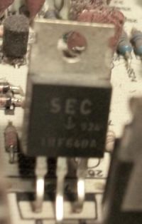

For the FET's...It's the IRF640A. Found the ratings on these, and they seem small for the design. If I stay under 24V could these work? I have quite a few on hand. .

And a pic (and some gnarly dust bunnies coming after it...)
1282097240 3075 FT0 Fet

With A 1uF cap, I suggest using a lower amount of turns. However, this means you will need a big inductor to limit the current. (I don't recommend those ones you have) And keep the Irfp640's on a heatsink. With that said, It will probably work. Good luck!

I don't mind using a different cap or inductor...the transistors are the more major concern (as they will be the most expensive to replace).
If I replace the other parts with new parts to spec, will those IRFP640's hold up on a CPU heatsink/fan, or will they be fried?

One of my ZVS driver uses cheep IRF540 MOSFET's and they work just as well as my other ZVS driver using more expensive MOSFET's.
So I imagine IRF640 should work well too, however, it may get warm due to the fact it can handle max 9A, I would put a heatsink on them. And make sure the MOSFET's tabs are isolated from one another if they are sharing the same heatsink!
