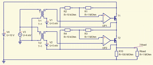

Still wondering ... why wouldn't a real implementation of this pseudo circuit work :
1
Of course you would need 7 1500V MOSFETs, with independent drivers with their own power supply (probably buck converters, seems easier than lots of transformers) and circuitry for getting it to power up without blowing up. Each of those MOSFET needs overvoltage protection, you need resettable overcurrent protection for the main high voltage power supply. Perhaps some filtering in the drivers if there is danger of spontaneous oscillation, etc etc.
Still, I don't see why this wouldn't work.
PS. used low supply voltage because the simplified models wouldn't work at high voltage.
[Edit: Size]

It is almost impossible to match the turn on delay- and rise-times for each transistor,
or turn-off delay- and fall-times.
the last one to turn on (or the first one to turn off) would get full voltage.

You don't really turn them on or off as such (they are always conducting, they have to ... because regardless of voltage sharing they can not handle the full supply voltage, most of it is always across the load). Each stage has a closed loop control following an input signal with limited slew rate (audio frequency). The drain-source voltages of the faster (higher bandwidth) stages will have some oscillation, but I very much doubt the amplitude will be significant.
