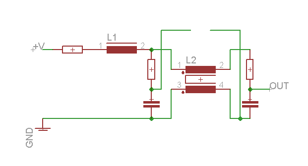

Pinky's Brain
Thu Jun 03 2010, 02:17PM
Pinky's Brain Registered Member #2901 Joined: Thu Jun 03 2010, 01:25PM
Posts: 837
Proud Mary wrote ...
The problem with inductive charging is that the Marx starts to think of itself as a lumped-constant transmission line, and may act out as a resonant charging system. If the charge on the capacitors, and the current through the inductors isn't exactly nil at the end of the discharge, L and C start talking to each other - backwards and forwards in queasy undulations - the sultans of swing! smile
Would a small series resistor help?
Something like this :
Marx

Thu Jun 03 2010, 03:50PM
To El Pinko:
Pinky's Brain wrote ...
Bound to! smile Critical damping is the way to go, so long as by 'small resistor' you mean a very generously-rated, fireproof, resistor of low ohmic value.
