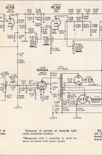

RCA, tv, 1956 that could use a flyback like that and the wiring used. edit the 6DQ6A was known for snivets!
How much did it cost and was it in a lot of old specials they were selling; Just think of its value to a vintage television restorer !

That's just the kind of circuit I had in mind for our friend's LOPT - smile a very similar HV set up.
