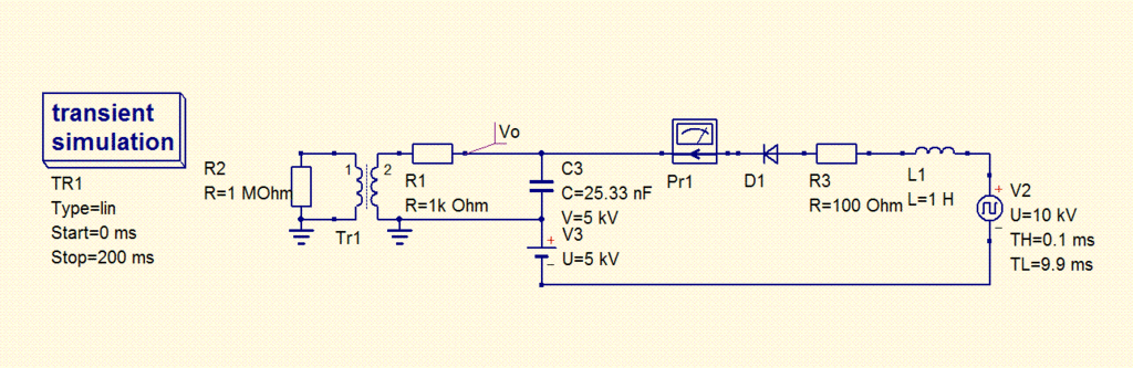

Any way, something like this works in simulation at ~5 Watt (although that doesn't take into account losses in the flyback).
Hvsine
I'm suggesting you use the secondary of a transformer like a MOT or a car ignition coil as an inductor with bunch of HV capacitors to form a 100 Hz resonator at high voltage ... the primary is left essentially open, but you use the voltage on the primary to sync a flyback which gives the resonator a kick each time it's at peak positive voltage. You need to use a flyback with a substantially lower secondary inductance than the main inductor.
The 5 watt goes entirely in ohmic losses in the big inductor, but there is no way to avoid it really if you want something which is approximately a sine. A NST or a normal AC transformer is going to burn a lot more power than this.

C3 and L1 in the simulation circuit resonate at 1000 Hz.

That's what the diode and the 5 kV DC supply are for ... L1 would be the secondary of the flyback transformer being used in true flyback mode (but I couldn't be bothered to simulate it to that extent). The flyback demagnetizing current only pulses C3, which resonates with the secondary of Tr1 the rest of the time.
If you do the regulation of the flyback primary pulse length in the non sophisticated way (trim it with a pot) you could drive the circuit into a >5 kV oscillation with some nasty effects though.

The circuit is in natural resonance, and is given a kick when it's at the top of the sine. So it's a sine with a small bit of distortion. Just run the simulation :) (It's for qucs, a free simulator ... but a bit temperamental, often it won't be able to get the simulation going and you have to tweak random things to get it to go.)
The simulation used a free running pulse source, but in simulation the resonance frequency can't drift. In reality it would, and since you are only adding a small bit of energy to the system on each cycle you can't afford to add it at the wrong time. So you differentiate the voltage on the primary of the resonance transformer, and pulse on the downward zero crossing.
As for how the pulse is generated. A flyback transformer with bottom of the secondary biased to -5 kV so it doesn't start conducting from ground on the bottom of the sine. L1 and D1 in the diagram would be the secondary and rectifier of the flyback (and R3 the winding resistance).
The selection of the flyback transformer is not entirely trivial. Might have to design/wind your own. Something like 20:1 winding ratio, 200 volt supply on the primary with a 1 kV IGBT or power MOSFET for pull down (when it switches off the bottom of the primary goes to ~700 volt).
