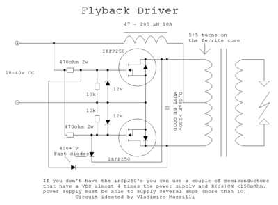

do you have some schematic ??? i have failed many times trying this

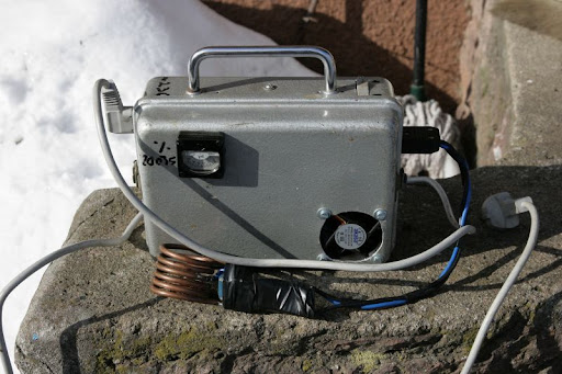

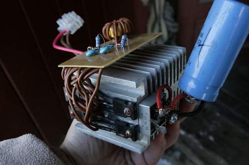

Simple ZVS from Mazilli from HVwiki, +39p capacitor paralel fast diodes.
Mazilli1
Old version with 35A rectifier
IMG 7619
Ready to use :)
IMG 7609

IH on a wand. Very nice!

for IH IRFP450 is not good. RdsOn=0.4Ohm, this is 5.6V@14A=78W heat.
PCB traces prorably to long.
Here can see my PCB, same schematic for another use
IMG 7615
IMG 7599

what are the minimum parameters to look for when choosing a MOSFET for the Mazzilli circuit ??

Minimum is Uds>3*Vcc, and RdsOn<0.1Ohm
I make many tests and many variations, low and high power.
Small (10-20mm) Inductor coil does not work.My working coils are 100mm 2+2wind., 55mm 3+3wind, 25mm 6+6wind. best heating at 90-150kHz

also what parameter determines the zener to use my gues is that is Vgs,
is there a way to use a separate PSU for the gates ?
BTW, the inductor on the 12v line conected to the center tap of the main inductor, what is the best to use ?

2 Ed- zeners is for gate protection
