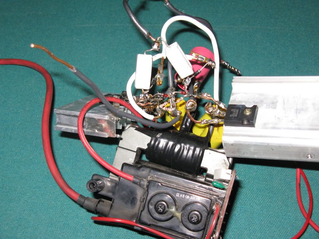

Below is a picture of the assembled circuit. It does look like a bit of a rat's nest at the moment...
IMG 0532
[Edit: Big picture]
Ugly as it looks, the connections are all solid, and nothing is touching that shouldn't be.

That is ugly... :)
Try and aim for something like this:
The only question I have from the pic is the inductor, is it aircored? I do not think it can be that high inductance with that. Do you have the means to measure its inductance? If not, Tell me the specs of the coil (if it is aircored), and I will try to wind one and measure the inductance with a meter.

I think you will have better sucsess when it is more orginized. I can see some thing right off and that is that your heat syncs may be making contact through the bar that holds the flyback together

While it may appear to be quick and cheap, the "rat's nest" construction style makes it difficult to trace the circuit, very difficult to inspect for shorts and cold solder joints, and makes it easy to overheat small components like diodes during soldering.
Do yourself a favor, invest a few dollars in some perfboard and push-in terminals, and rebuild your circuit. Especially if you don't have any test equipment which will allow you to "see" what the circuit is doing, building a neat, clean layout will improve your chances of success.
