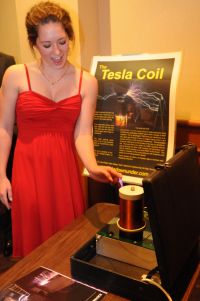

Notice anything about this photo?
Clearly not quenching because the static gap was set too narrow. Was OK at lower voltage with a variac but not on full mains as it heated up.
A quick pinch of the gap with pliers and it was back to 3 inch sparks.

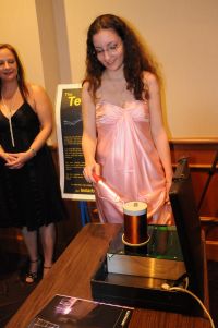

Mostly the non technical public (including Australian ladies) will find a TC interesting for a short while. The possibility to interact with one and watch others interact with one (like the boyfriend) makes the difference. The ability to have a bit of fear induced, then to conquer it by have sparks onto your hand and a bit of a tingle, does give a buzz though. That feeling makes people come back with their friends. It's interesting psychology.
Pic shows ladies lining up to investigate the quenching problem.
