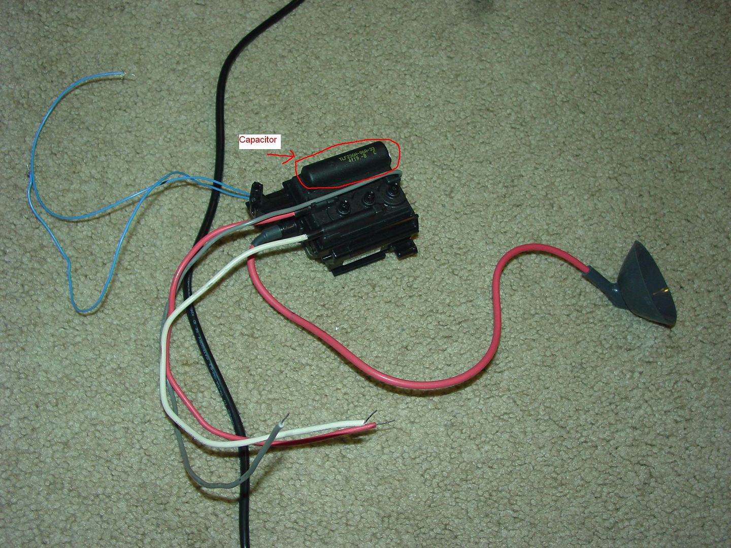

Check if everything is okay, your new driver should not be a problem.
Your LOPT seems to be a LOPT from a monitor, I would try to short the HV output with ground (GND on the LOPT) let the device run for about 10-15 seconds then try to draw arcs, this will let the internal capacitor charge.
If this is not the problems try to squeeze the red HV cable further in to the LOPT.
There could be an idea to test your driver on a light bulb before you try it on a LOPT.

That's clearly a monitor flyback. The cylindrical part sticking out of the side is the capacitor. You might be able to mod it and make it work for arc drawing, but IMO it might be easier to just find an old tv and get the capacitor-free flyback from it. If at all possible try to find one of the old AC disk flybacks as they work the best for this kind of stuff.
I can't see any capacitor there myself, and the only 'cylindrical part' I can see is the secondary winding itself.

I circled the capacitor in red. I've actually cracked monitor flybacks open with a hammer before and I'm pretty sure that the circled part is a cap. Recently I tore a bunch of old monitors apart and the flybacks all had a cap like that on them.

SO I bought a replacement part for my 2.2uF capacitor... its finally come! ANd its working!!! I think...
I turned the thing on, and I started to hear sizzling.. I brought the H.V. main line close to (any) of the bottom probe thingys... and it sizzled LOUD!!!!! I only brought it close, not close enough to arc. I am very excited, but I want to make sure I am not going to hurt the flyback before I continue... I did not ground the flyback, and I am not going to be stupid... I am going to wait until someone gives advice on why its sizzling when its not close... (BARLEY sizzles)

It is sizzling because it is high voltage XD.
Flybacks sizzle, that is from the high voltage, it is fine. I have NEVER grounded my flybacks, perhaps i should start doing it.
Just find which pin is ground by bringing the HV near the pins, and when you find which one it is solder a wire to it! Drawing arcs usually will result in a pin burning down, or just melting the 'stuff' and that helps cause carbon tracks.
