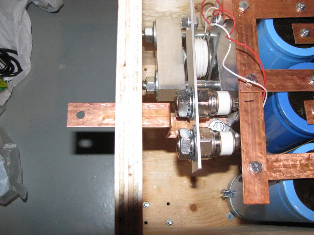

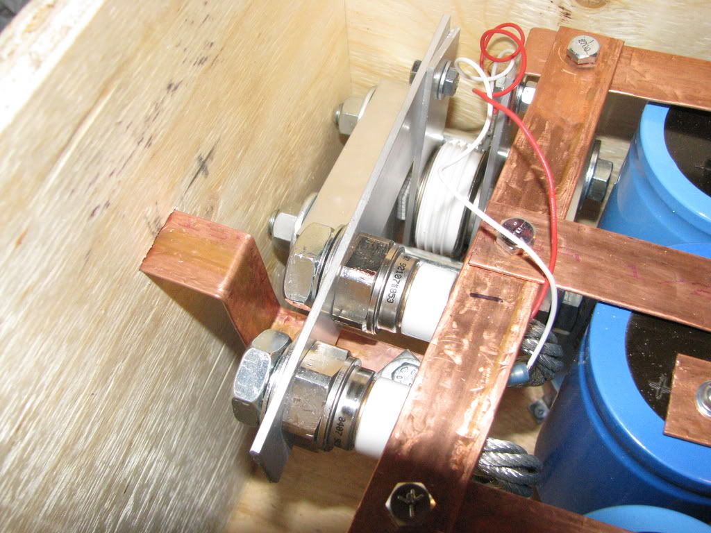

The solder should work since if the joint is properly made, it should fill the contact area voids between buss bars over a 1.5cm x 1.5cm area.
Also, I realized I forgot to mount rp181's gigantic stud diodes, these diodes are going in *series* with the capacitor bank so that they cut down most of the back-EMF to where small diodes (TO-XXX) can handle the remaining pulse. The diodes should also push every bit of energy into the work coil, and then some...
Also, the capacitor bank controls and charger will be mounted on the side of the capacitor bank, I will add a remote trigger so that I don't have to be so close to the bank, at least until I get longer lengths of welding cable (if I can afford them that is).

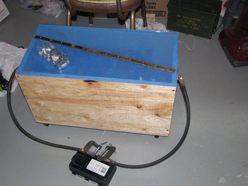

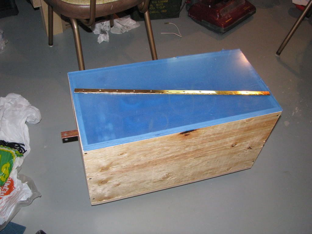

Anyway, more pics:
IMG 2512
IMG 2513
IMG 2515
IMG 2516
Isn't it so disarmingly benign looking? The blue protective plastic will be removed once I get the acrylic mounted with the hinge, just so I can avoid scratches.
