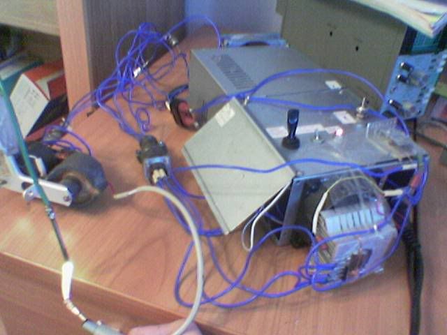

LithiumLord
Wed Nov 05 2008, 09:00PM
LithiumLord Registered Member #1739 Joined: Fri Oct 03 2008, 10:05AM
Location: Moscow, Russia
Posts: 261
Don't forget that you can fit two secondaries on a generic TV core.

Masih wrote ...
Please Explain more. you mean driving two flybacks in series driving by a ZVS Driver?
No, I mean this:
(a pic of my first driver, a 555-based push-pull - you can see a double-secondary flyback to the left)
