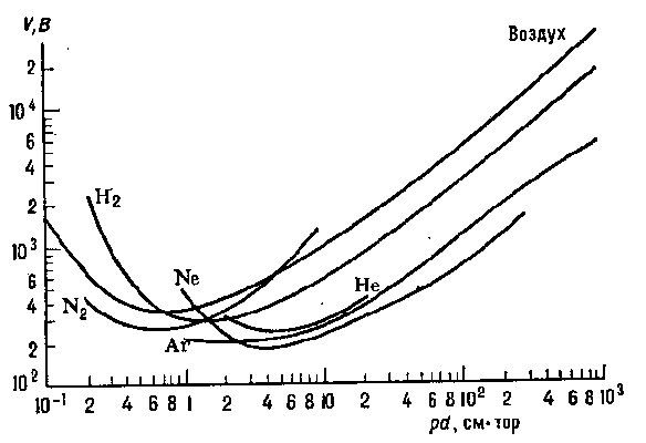

LithiumLord
Mon Oct 20 2008, 12:37PM
LithiumLord Registered Member #1739 Joined: Fri Oct 03 2008, 10:05AM
Location: Moscow, Russia
Posts: 261
PanosB_GR wrote ...
The dielectric strength of clean air is 30kV/cm
...based on the linear approximation for the higher voltage ranges ;)
watch this!
ps sorry for the russian pic, the air curve is the one that ends higher then the other ones, the X axis is pd [cm*Torr], Y - voltage in volts.

DrZoidberg
Wed Oct 22 2008, 04:24AM
DrZoidberg Registered Member #350 Joined: Mon Mar 27 2006, 05:14PM
Posts: 106
Dr. Kilovolt wrote ...
"For example, at 1 Torr... If 500 Volts were applied, it would not be sufficient to arc at the 2.85 mm distance, but would arc at a 5.7 mm distance."
Now that's totally wierd amazed
That is due to the way a spark forms in air.
It has to do with free electrons. The process is called avalanche breakdown.
At very small distances electrons don't have enough space to accelerate to the required speeds.
