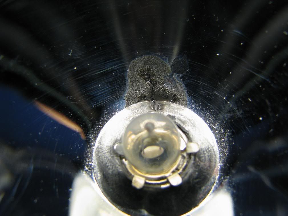

aonomus wrote ...
I tried modifying my circuit with the protective diode and extra capacitor across the transistor collector/emitter, and it didn't like it. Flyback HV voltage was reduced a fair bit (couldn't arc through as many tubes, arc length reduced), and the capacitor got darned hot.
you have a bad capacitor. It should be pulse rated or at least any PP cap. Try different values also.
aonomus
Mon Jul 21 2008, 03:57PM
aonomus Registered Member #1497 Joined: Thu May 22 2008, 05:24AM
Location: Toronto, Ontario, Canada
Posts: 801
Thats what I guessed, but it was 3am when I tried it, I wasn't going to risk any more HV experiments till I was awake again. The cap was a 250v, 0.47uF metal poly cap (blue ceramic enamel case, radial leads). The diode does help reduce transistor temperature, and I might try putting a bigger cap in next time I get the chance.
Update: Tried it with a different poly cap, 1 uF this time, and I figured out what was wrong, it wasn't the cap that was bad, it was the alligator clips that were too low gauge to handle the current.

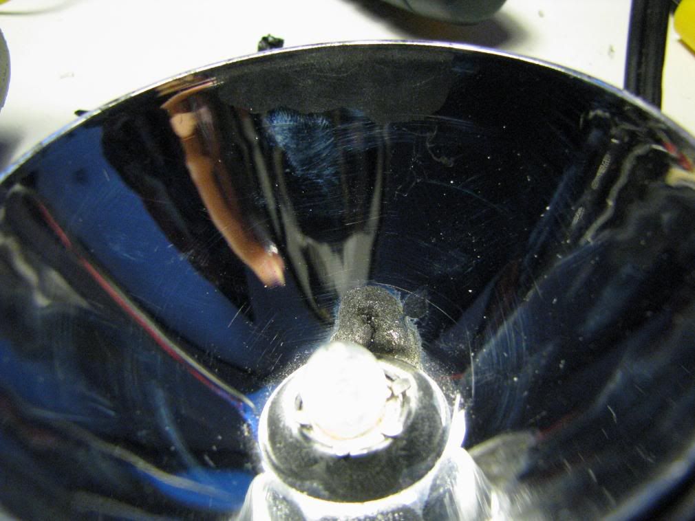

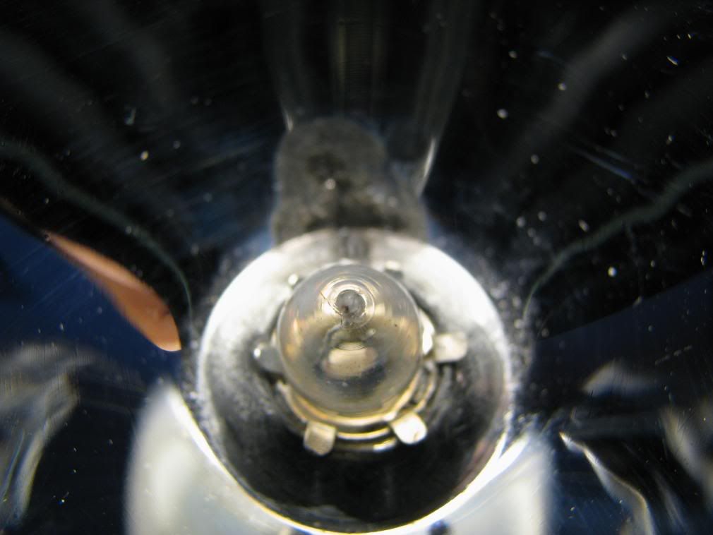

Update 2: HV is fun, I turned a flashlight bulb into a plasma globe right up until the glass cracked leaking the gasses out. I then started charring everything else on the reflector, making some cool patterns....
IMG 0258
IMG 0259
