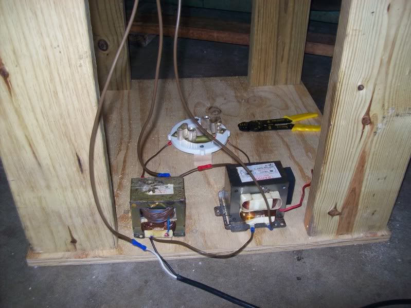

Lets not forget what shunts do. They effectively lower the mutual inductance between the primary and secondary, which is equivalent to lowering the coupling, which is the same as having excessive leakage inductance, i.e. a ballast. This extra inductance will have a voltage drop that is proportional to the current through it. So, get those shunts outta there!
Also, id suggest using a variac, at least the first time, to power up the filaments with your home-brew transformers, just to make sure you didnt over do it. Remember to probe the filament voltage AT the pins of the tube, otherwise you arent accounting for voltage drop in your wiring and connections.
For a soft start, i often used a series resistance of a few ohms (1-5 would be about right) rated for 25-50W. Just run the resistor in series with the filament supply, and short it out with a switch after a couple seconds. With the resistor you should get up to a nice glow (like a low wattage light bulb), and then you can hit it all the way with full power.

MOTS being as the least expensive part of most any setup, work to get that end correct! I'd knock the shunts out, sure. But I'd also get others to insure that what I was pairing up with that big old tube was what was really appropriate!
....Meaning that if it's not really on the money, set up another one that puts out the exact voltage/current level you need. Working with a small x-former and trying to form the secondary correctly might be a pain.......MOTS are cheap.

Well i made some progress on the base and did a little bit of wiring.
I bought two switches, one for the filament supply and one for the B+ supply. I also did the wiring from the filament mot and mounted the socket, switches, and mot's. The voltage at the pins of the tube is 10.1 volts. YAY! I suppose tomorrow i will rig up a soft start switch and resistor. I also ordered the wire for the wiring and primary yesterday so it should be here tomorrow or the next day unless he doesn't ship until payment is received. I also found a riding mower today that seems to be in good condition so i should be able to make a little more money, which will go towards this projects and then my 6 inch coil.
Just the base's current progress.
The bottom of the base. Filament supply mot on left and B+ supply on the right. I have the filament bypass capacitor mounted below it for easy of wiring. I just put some terminals on the capacitor and screwed the socket down.
I had to mount the socket on top of two blocks of wood because of the screws that protruded from the socket and i could not just screw them into the wood or it would scrape the ground. I know that this thing is going to be much bigger than necessary, but i am no good at this kind of thing. I should have just mounted the socket on the top so the top of the base could be much lower, but i want the tube to be as far away as possible from the sparks. I still need to make a topload, but after mowing all the grass with my new mower, i should be able to make a nice on :P.
