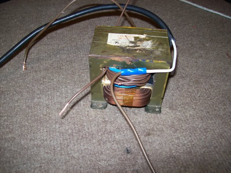

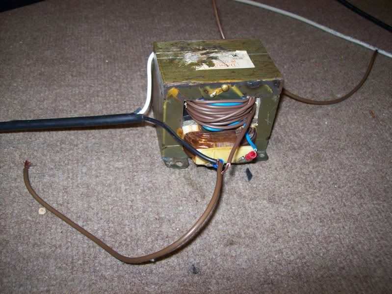

I am going to be getting an 833c(Thank you Chris!!!) soon and i figured i would start working on it and i also figured i would begin my project thread. Today i made the filament power supply transformer. It is just a simple rewound MOT, but it had a slight problem. After about one minute of running with no load the primary was too hot to touch. I rewound it with 10 turns of wire that seemed to be the same thickness. It helped alot and the heating has decreased significantly. Now i can run it for 2 minute no load and it is only lukewarm. I have about 12-15 turns of 14 gauge(i is a very small mot!) and it puts out 10.3 volts. I am hoping for 10 volts under 5 amp load(the 833C).
Here are the pictures:

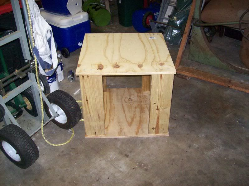

Well, i added a few turns to the secondary on the filament supply mot, and i tested it under an 8 amp load and i got 10.3 volts, hopefully i will not have to add another turn to the secondary to get 10 volts under 10 amps. I also made the base for housing the tube, circuitry and power supplies as well as the primary and secondary, so everything :P. All that is left to do with the base is stain, polyurethane and add the casters or whatever they are called cheesey . I also took a picture of the secondary and the base.
The secondary. I need to get something to varnish it with. Would regular polyurethane work? I covered it in tape because i didn't have it varnished and the windings started to overlap. Stupid on my part...
The 'base' or whatever you want to call it. I settled on two tiers. The bottom will house the supply transformers and the 833C as well as all of the circuitry. The top will just have the primary/secondary. Just stain and polyurethane for protection, perhaps sand it and add the casters. It can hold up a matthew so it is quite strong tongue . I used two pieces of 5 ply and 4 1 1/2 by 5 1/2's.

Knock the shunts off that MOT; you'll get better load regulation (less voltage drop under load).
The no-load input current may get a little higher, this can be fixed by adding a few turns on the primary.
