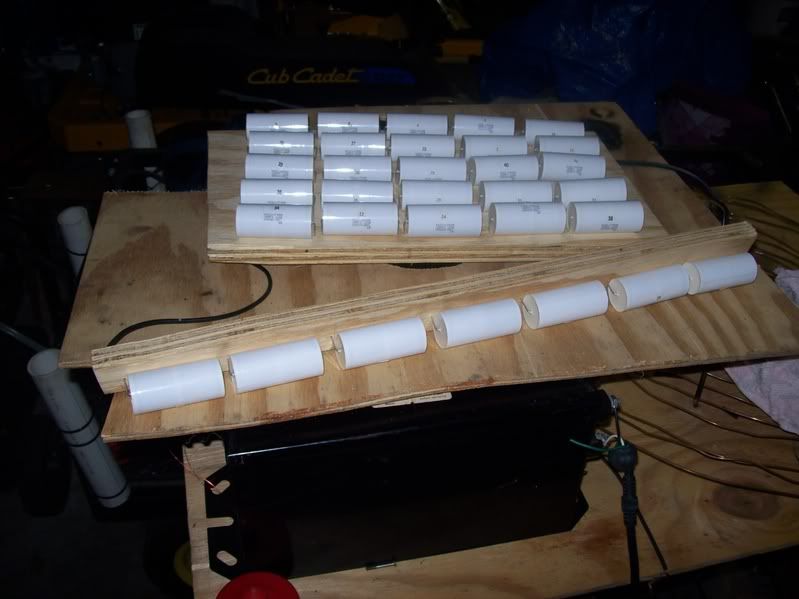

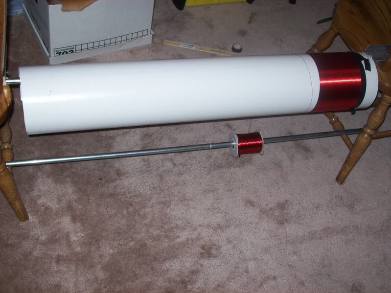

Well i have started a new coil, 6 inch in diameter and 30 inches long. I will be using rogers 2 mot and doubler setup, i would use 4 mots but i only have 100amps service :P.
My 6 inch coil being wound.
The mmc, made of 32 CDE .68uf 1600vdc caps. Will be tapped for about 40nf to 50 nf.
The twin mot circuit with doubler for power supply.
