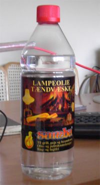

I've just discovered a liquid of great dielectric and viscosity properties. It is the lamp oil (the stuff for burning in the home lamps). Works perfectly and it has one more big advantage. It evaporates after some time, so when you work with it nothing stays oily (great for gluing etc...)

I wouldn't use that.
One of transformer oil most important feature is that it is highly non-flammable and when heated does not generate flammable fumes. I once burned my facial hair with lamp oil fumes from stove. dead

It is not so easy to ignite this oil. But the fumes are a good argument. It would have to be sealed without any air inside and only for mild temperatures (below 100C) emitting devices. But sparking inside the oil is harmless I tested it. (you need oxygen in the oil to start a fire). However you 100% right, this could be a pretty dangerous design...

The flashpoint of generic lamp oils is generally between 60° C and 120° C, depending on the proportion of aromatics.
If an oil filled transformer case is to be hermetically sealed, then it is essential to make provision for the expansion of the oil as it heats, or the case will leak or even burst, as the oil is all but incompressible. Allowing an air - or gas - space at the top of the transformer is a common solution.
