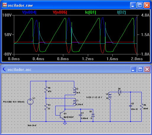

Yes. The operation is, essentially:
1 - The collector current rises in a ramp from zero while the base current is constant.
2 - When the transistor leaves saturation, the collector current ceases to increase.
3 - The base current goes to zero because dic/dt is zero.
4 - A large positive pulse appears at the collector, caused by the current in the upper inductance charging the capacitor and the load capacitance, while a negative pulse appears at the base. The amplitude of this pulse is clipped if the be junction ruptures. Maybe good to put a diode in series with the base to prevent this, and a resistor between base and emitter to discharge the base. The zener+diode that I suggested before would just cause clipping at a smaller voltage.
5 - The pulse falls and tends to become negative, being clipped by the diode across the transistor. When the pulse returns to zero the cycle repeats.

Maybe I'm wrong but this is how I think the circuit works;
1) Transistor gets turned on by the resistor divider.
2) Voltage gets induced on the feedback coil. This voltage forces even more current through the transistor base.
3)As the transformer core saturates, the base currents starts to fall until the transistor goes out of saturation.
4) As the transistor turns off, the magnetic field collapses, and induces a high voltage pulse of OPPOSITE polarity on all coils - so this forces the base voltage to go negative, shutting the transistor off, untill the voltage "flies back" . The cycle repeats.
If the primary-feedback phasing was opposite, the circuit would fail to oscillate, because the HV spike of opposite polarity would force the transistor ON instead of OFF - so it would never happen.
EDIT - Here are quick MS Paint waveforms, in no way accurate, but they illustrate my idea good enough:

The waveforms assuming that the transformer does not saturate are similar, but the current grows linearly. I show below the result of a simulation with SwitcherCAD III, showing the voltages at the collector and at the base, and the currents trough the collector and the diode across the transistor. The simulator assumed that the be junction does not break down.
