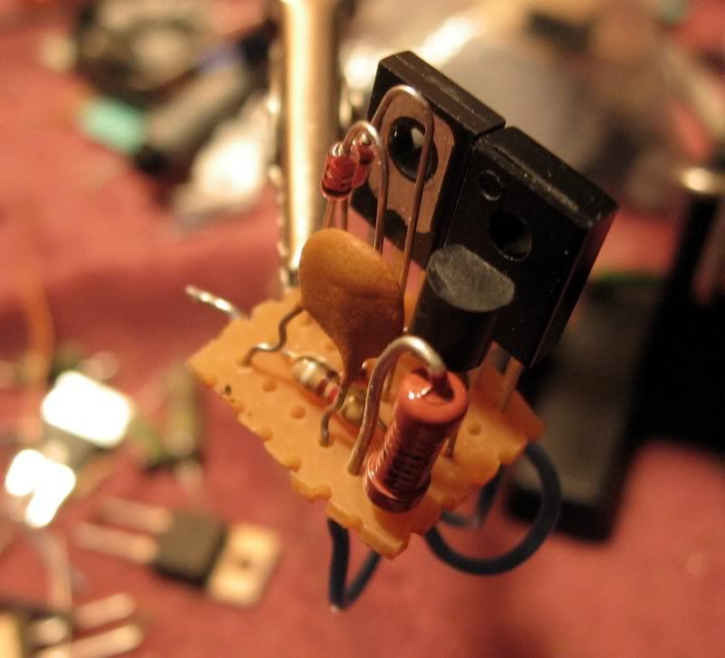

I didn't notice the hint about values from Steve in previous post, or he did edit in secret, but the trick with capacitor connected parallely with base resistor helped a lot. The base resistor is 9kohm, seems to work fine.
The first prototype of RTL inverter (Resistor Transitor Logic):
Rtl Prototypev1

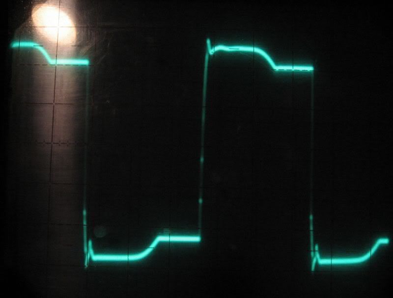

The upper waveform is a inverted one, the second comes from NE555's output, which is very similar to one after BD's totem pole. Notice that inverterd signal has rounded begin of on-time signal part.
Inverted Signal
That's a waveform after plugging probe to two BD's totem poles outputs. Little ringings are visible, but it's possible to fix. The peak to peak voltage has doubled and seems to be working as it should be.. that's what I thought until I did plug GDT with loads. At this moment waveform was really messed and I don't remember why. Whatever, after few hours I had some decent waveforms, but soon after driver started to work horrible. In case I don't find reason, I will build another prototype of whole driver.
Bd Fullbridge Noload

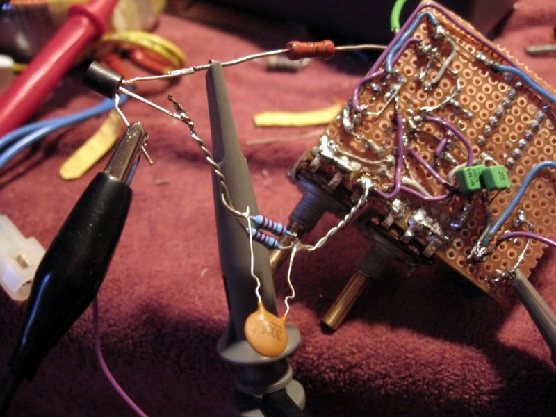

Second prototype of RTL inverter, didn't work. Third one was a prototype that gave decent waveforms I said about earlier. No photo of it, this time.
Rtl Prototypev2

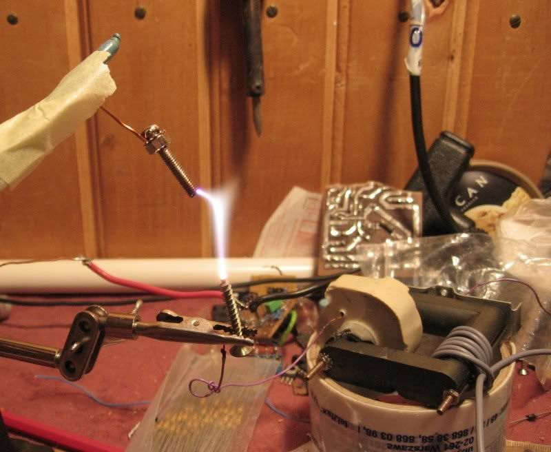

When I was trying to get proper waveforms, I've decided to relax a bit in meantime. GDT plugged to one totem pole, two IRFP250's, 70kHz and +30V supply voltage for half-bridge smile
30V Irfp250 Onetotempole
