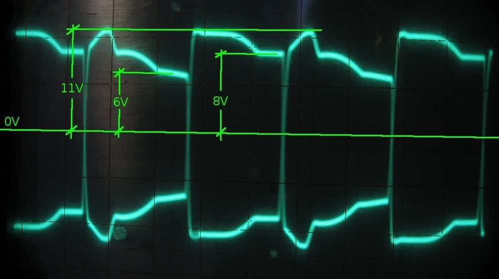

The waveforms look great, now you just have to wind your GDT for 1:2:2 because currently your GDT will only give 5V of gate drive. Staircase waveforms are completely normal, and the only reason you would need to worry about them is if they exceed the mosfet's maximum gate voltage. The ground line is where the scope trace is with no voltage applied to the probe. Positive voltage will be above this line, negative below. If you switch to DC coupling on your scope you can see where the bottom part of the waveform is compared to the ground line. Low-noise resistors are of no use at these frequencies.

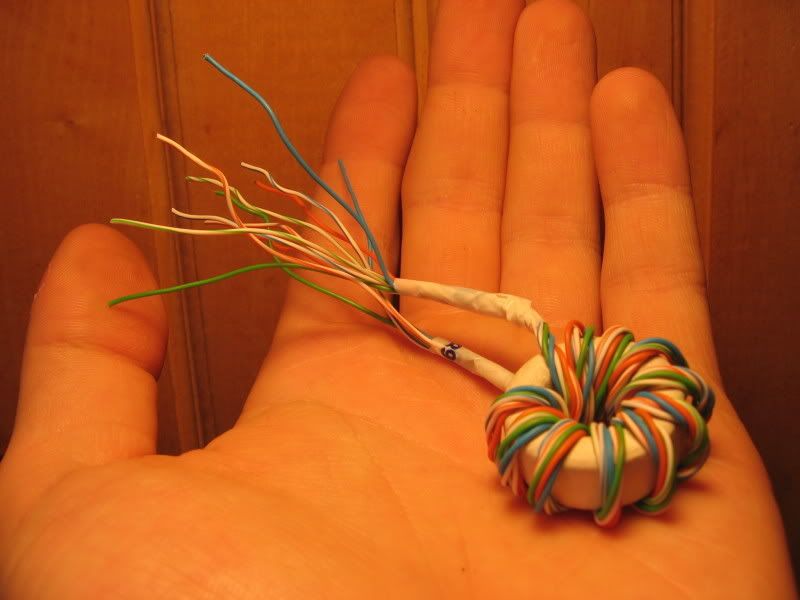

In hurry I wrapped 6-filar tongue But, I did notice if I use two wires in paralel for primary, overshootings slightly decreases. Now I don't have any blurry waveforms with two loads, but slopes are deeper. See photos:
New GDT, smaller core and 10 turns of UTP wires: Link2
Waveforms, 0.5 V/div, 2.2nF capacitors and 37ohm damping resistors: Link2

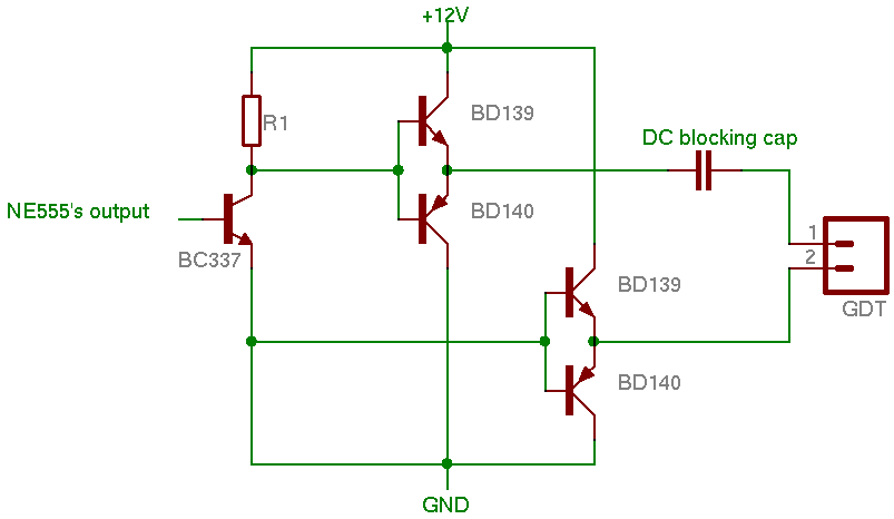

The another thing is question about driver. Is there's possibility to add another half-bridge at NE555 side? The reason I'm asking because with full-bridge the output voltage doubles and I wouldn't have to mess with 1:2:2 GDT. 1:1:1 is much easier for me. Does anyone know, how to invert NE555's signal in very simple way?

You could use an inverting chip, or just a single transistor set up as an inverter to invert the signal. It would increase gate drive power too = better waveforms than 1:2.2.

Link2 It's near the bottom of that page. Send the 555 output into it, and the output from the inverter into a new BD1XX stage. When I said inverter chip I meant any inverting logic chip, such as the 4049. The output from a logic chip must be boosted by a transistor totempole.

At this moment, I have no idea what resistors use for transistor inverter. The transistor I have is BC337 (NPN 45V 800mA). I know that resistor between +12V and collector is supposed to limit current flowing through collector-emitter. I gave there 1kohm (12V/1000ohm=12mA). What does a resistor in series with base, I don't have much idea. Probably limits current draw from input, but NE555 should give much current as BC337 wants, so I skipped this resistor. In that way I don't get proper inverted squarewave between 1kohm resistor and collector, it's a rather flat line with small spikes there where are switches. Like as something is shorting or too big resistance. What values would you suggest?

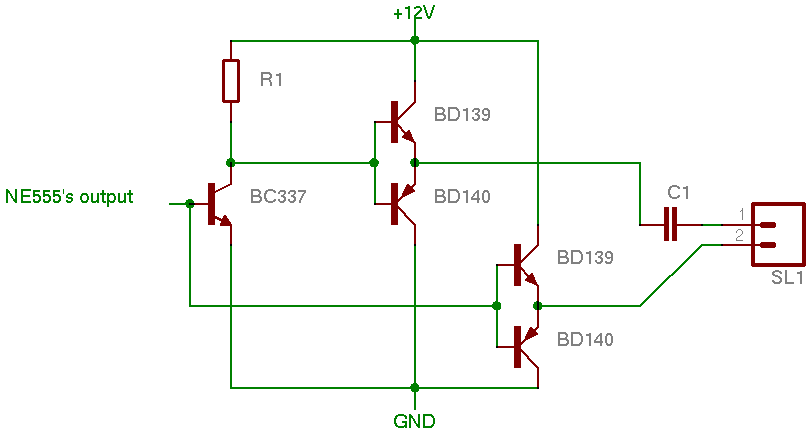

Also, I have two ideas to get two signals for full-bridge of BD's, below you have schematics. Is there's practical different between them in terms of outputs?
scheme nr.1 : Link2
scheme nr.2 : Link2
Tue Dec 04 2007, 11:32AM
The base resistor is needed otherwise too much current will flow from the 555 and destroy the transistor, and maybe the 555 too. 10k is a usual value. If this makes the switching too slow, don't make the resistor smaller: put a few hundred pF capacitor across it instead. Or choose a different transistor with less charge storage.
