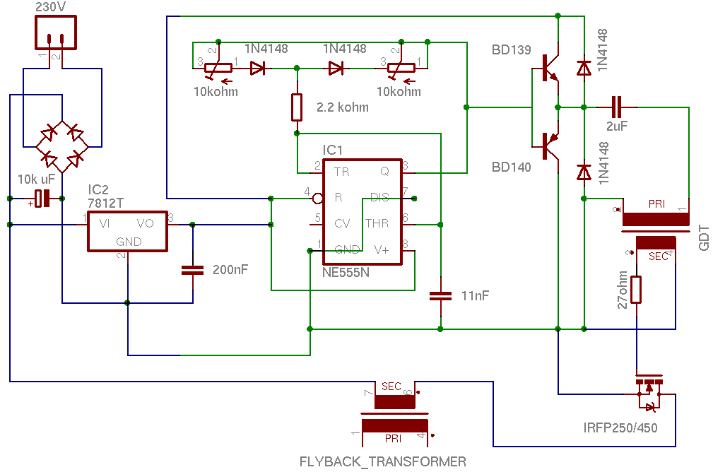

I've connected like as Richie done with UF4001's (look scheme, few posts above), it's the same as you say? Those steps I have at the moment are around 1.1V.

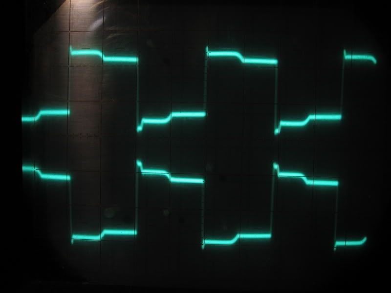

Next problems - when I lower frequency, tops and bottoms of squarewave are more half-circle shape. As my dad return, I will post pictures of waveforms. Second problem is that transistor is still heating, when it's connected to GDT. When I plug +30V to flyback transformer's primary, the waveform is blurried (it doesn't depend if I draw arc, or not). Perhaps it's caused by field created by flyback transformer and causes oscilloscope disortions? Transformer is 0.5m away from probes. I guess it's hard for you to figure out what's going, so I'll wait unless I do photos and update scheme, including those changes I did for your suggestions, GDT and flyback transformer. I hope it will be clear for you :)
EDIT:
There's updated scheme: Link2

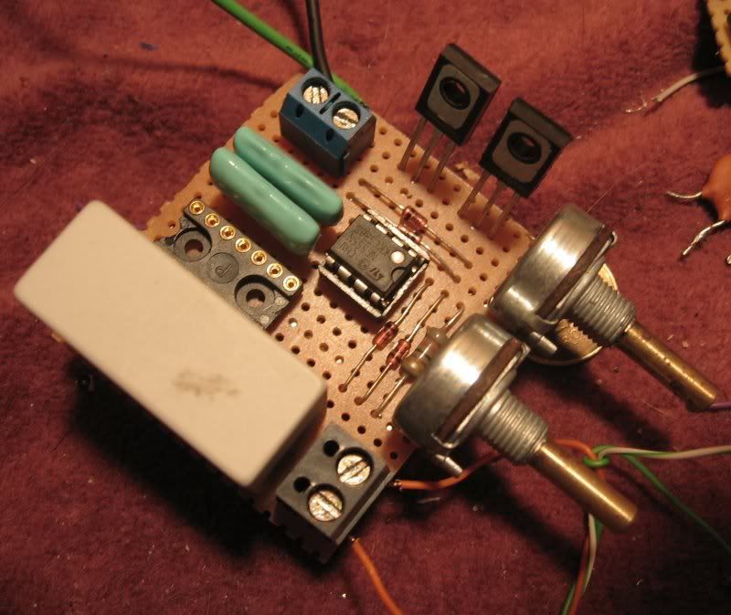

I built new PCB. Now it's less messy. There is his photo: Link2

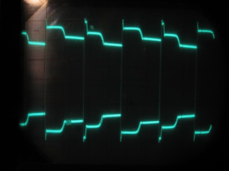

I played with it a bit and there are my best results as so far (though, they don't differ much from previous).

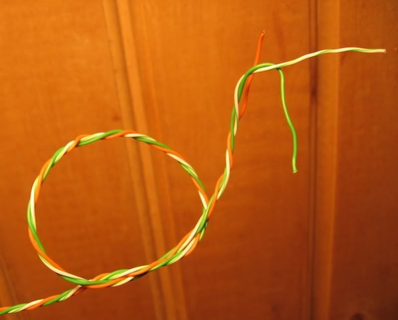

The wire I used for GDT came from UTP cable: Link2

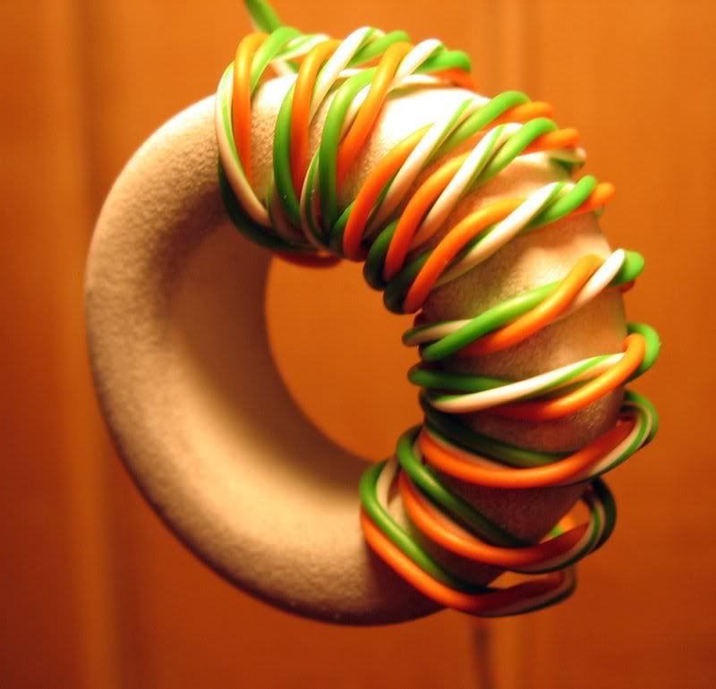

Wounded GDT: Link2

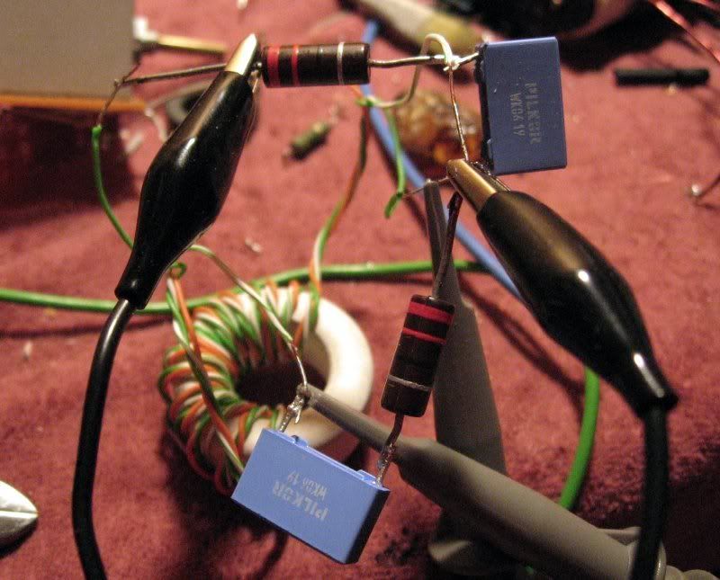

GDT's dummy loads consisting 2.2nF capacitors and 27ohm resistors: Link2
Two outputs and comparing them: Link2
Separated waveforms: Link2
There are measurements of one output: Link2
Well.. conclusions? GDT has 10 turns, wires are twisted and trifilar, they're tighted on core. No problems with fall and rise times at ~50 kHz, as you can see in photos. No any ringing, but I'm think I'll add more damping resistors in order to decrease overshots, which are ugly for me. I'm still concerned about stair shapes, are they really normal? From measurements I've taken I would say they're bad for transistors. But there I must ask you something important, how can I figure out if bottom part of waveform is below 0V or above? Uzzors, what waveforms you had with this driver?

Sat Dec 01 2007, 07:08PM
Tonic wrote ...
Next question. Is it worth to buy low-noise resistors? I'm wondering how they will work at high frequencies.
The waveforms look great, now you just have to wind your GDT for 1:2:2 because currently your GDT will only give 5V of gate drive. Staircase waveforms are completely normal, and the only reason you would need to worry about them is if they exceed the mosfet's maximum gate voltage. The ground line is where the scope trace is with no voltage applied to the probe. Positive voltage will be above this line, negative below. If you switch to DC coupling on your scope you can see where the bottom part of the waveform is compared to the ground line. Low-noise resistors are of no use at these frequencies.
