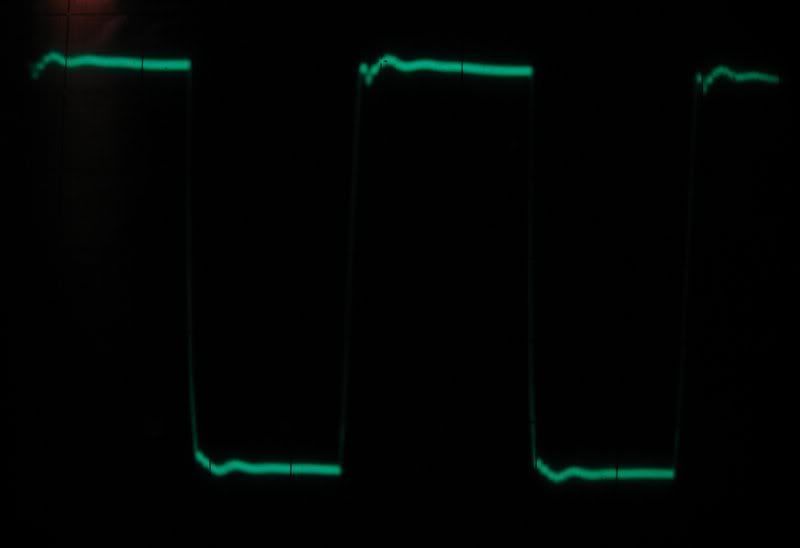

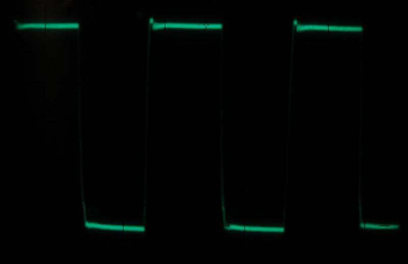

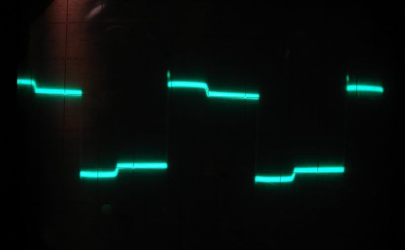

jmartis, no difference. But I checked something and I was surprised. I did unconnect BD139's collector from +. Nothing changed. Plugged again. Again, nothing changed. I thought transistors were soldered in wrong way, but no luck, I've checked pinouts from datasheet few times and it seems to be okay. What it does mean?

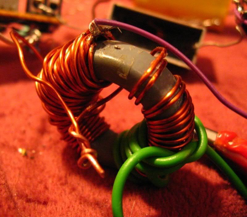

Anyway, I tried with iron powdered core that was laying around. The results were a lot better. Just see pics. The copper wire is primary, green wire a secondary.
The GDT core itself: Link2
Primary with no load: Link2
Secondary without load: Link2
Secondary with load (IRFP + 10ohm resistor): Link2
Very similiar, the only difference is overshooting which was biggest at secondary side with load. What do you think?

If the 555 puts out this crappy wave there must be something wrong with it, or its overloaded- it doesn't like overloading when its connected up like in your schematic (feedback from output).
Tonic wrote ...
It means that the 555 was driving the GDT through the upper transistor's base junction

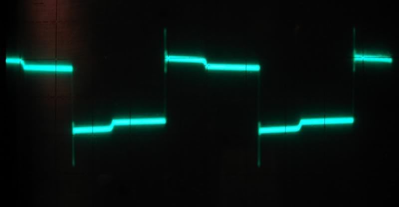

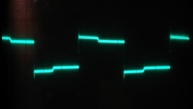

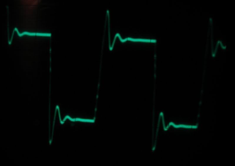

By the way, I've tested iron powdered core at 570 kHz frequency. After reading people saying that iron ones are a no-no for high frequency, I was surprised that waveform improved instead of being ruined.
Primary without load: Link2
Secondary with load: Link2
I didn't notice any core heating.
I have the feeling that my problems with ferrite GDT cores is a matter of turns.. guys, say, is it possible that I might need tens of turns to get square wave? From what I saw, I thought that at least 10 turns is enough.

I think it works as it should, just when you disconnect the BD from supply, the 555 takes over (through the B-E diode). There will be some drop of output voltage, but it can be very small if the output current isn't overly large.

It worked well for me right from the start, but it wasn't the first time I played with GDTs. I got 1 µs rise-times when running two IRFP450s, so at 500kHz it was mostly sinewave drive. At lower frequencies the waveform was more acceptable. You seem to have it working now, your waveforms look good with the powdered iron core. The ringing at 500kHz is probably just due to leakage inductance. By using a trifilar winding style instead of delta you can minimize leakage massively. Link2
If you are still having problems with the circuit check that the output from the BD1XX totem pole is good before running a GDT. That way you can tell whether the drive circuitry needs fixing or the GDT. But with the BD1XX collectors connected directly to ground and +12V it should work perfectly.
