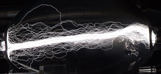

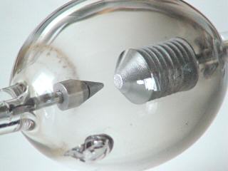

I think also xenon short arc lamps are not useful as a sparkgap. For the high pressure you need a high voltage. The ignition voltage of my 1600 W lamp ist 36 kV. I test it with my 8 kV neon transformer and nothing happens. With a 30 kV voltage transformer I get sparcs.

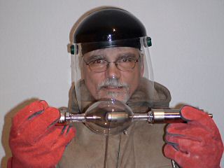

Of course they are dangerous, you must wear protection clothes.

In this lamp (7000 W) there are no sparcs between the electrodes, there are long sparcs inside along the glass bulb.
Tn Bild7
An interesting effect.
