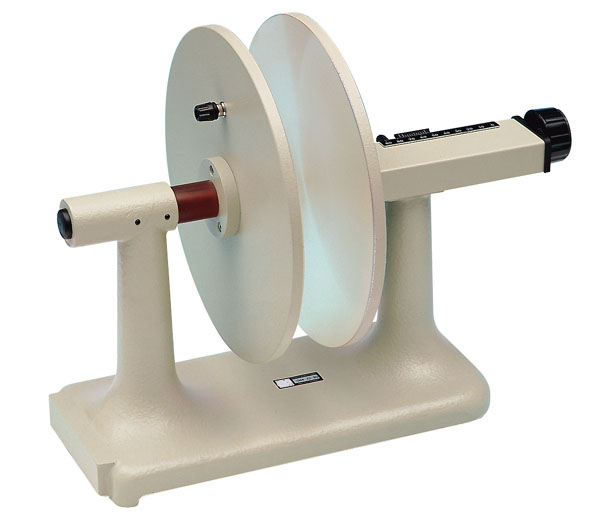

All these experiments with parallel plate air spaced capacitors (also when introducing "charged" dielectrics into the space between the plates) should be done with extremely good insolation against ground and all the DC voltages should be measured by using electrostatic voltmeters to get reliable and correct results.
Here is an example for a parallel plate capacitor with good insolation, only one plate:
54422
Here is an example for a swiss high quality electrostatic voltmeter up to 250 V:
Elektrometertrim1400x287 2
Once charged, the voltage remains almost unchanged for many hours.
