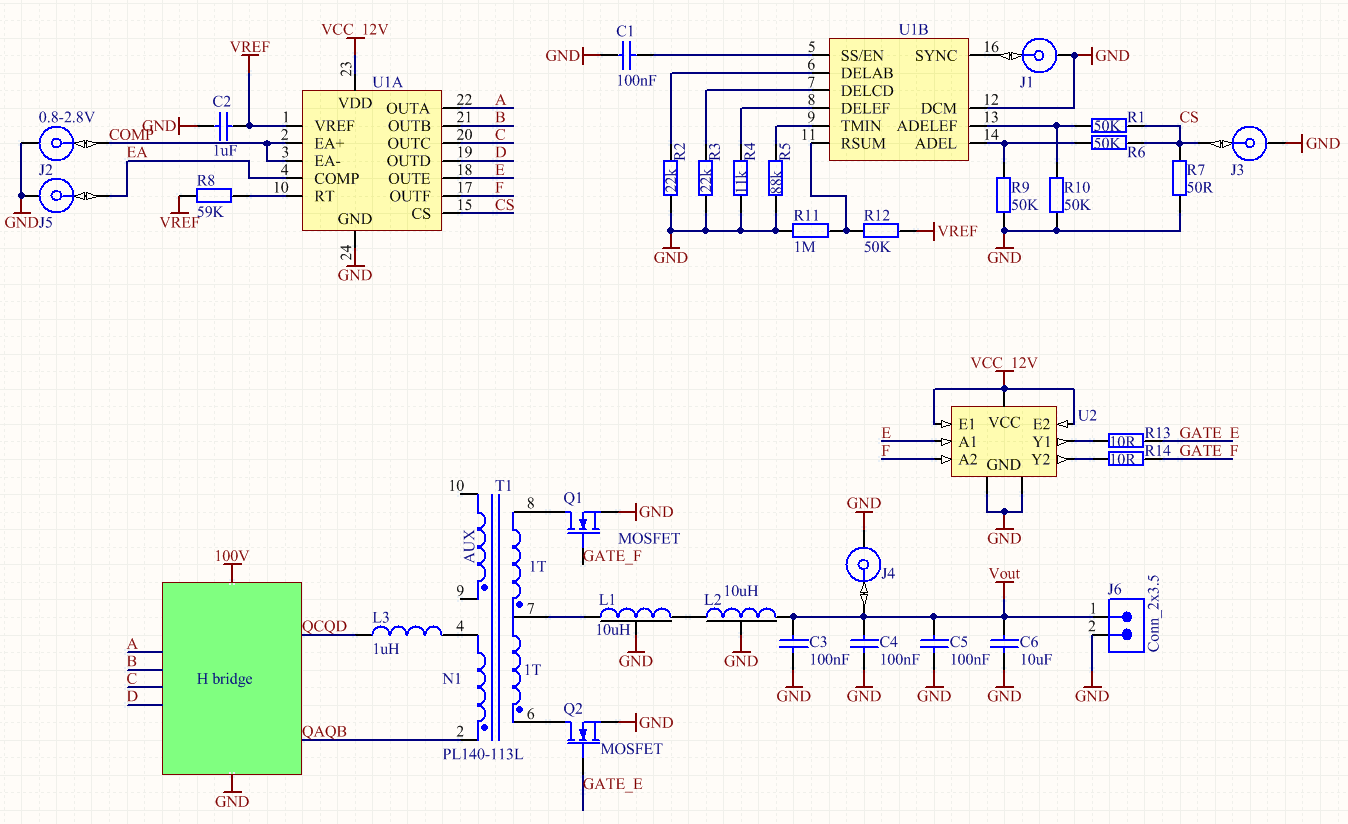

no, because where is no need to go for special chip, Half bridge controller will do the same. Also i need at least 10 times more power, as well i need to produce it from 220V/3phase input

Ok, i was a little confused by the LTC3722 abvoe which has comparable voltage rating to the Class-D. The Chip includes the mosfets so there would less work to do.
Running from rectified 3-phase is another story again. Also your proposed Mosfets only handle 200V, so they dont fit either. You also stated something with 100V..
High input voltages decrease efficiency (look at the "Converter Efficiency"-graph in the LTC3722 datasheet, 1st page) at any high frequency for a given load. Just extrapolate how 300V++ would look like. Hmmh.
Look at Link2 and see which low pulse rate is deemed appropiate for a motor. I think if done correctly you should simply be able to use IGBTs.
The question is frequency selection again:
as low as possible would be perfect. Using 6 - 12 pules per half wave is a common tradeoff (in 50Hz motors afaik). If you go higher than that you favor eddy current losses in the motor if you dont use a filter in front of the motor. A filter however will strain the system with additional reactive power transfer.
Linas
Sun Oct 30 2016, 11:26AM
Location: Vilnius, Lithuania
Posts: 721
DerAlbi wrote ...
No, HV does not decrease efficiency. it usually adds efficiency, then we are using resistive type parts ( mosfet's )
Doubling voltage increase power for same mosfet by a factor of 4
You are mistaking same setup that has to work from 30 to 80V, with one that is designed for very narrow window of input voltage.
Nearly finished my design that will test single phase at 10-150W, will see how it goes, after that, can make full power setup with high power mosfet's running from PFC or rectified mains.
