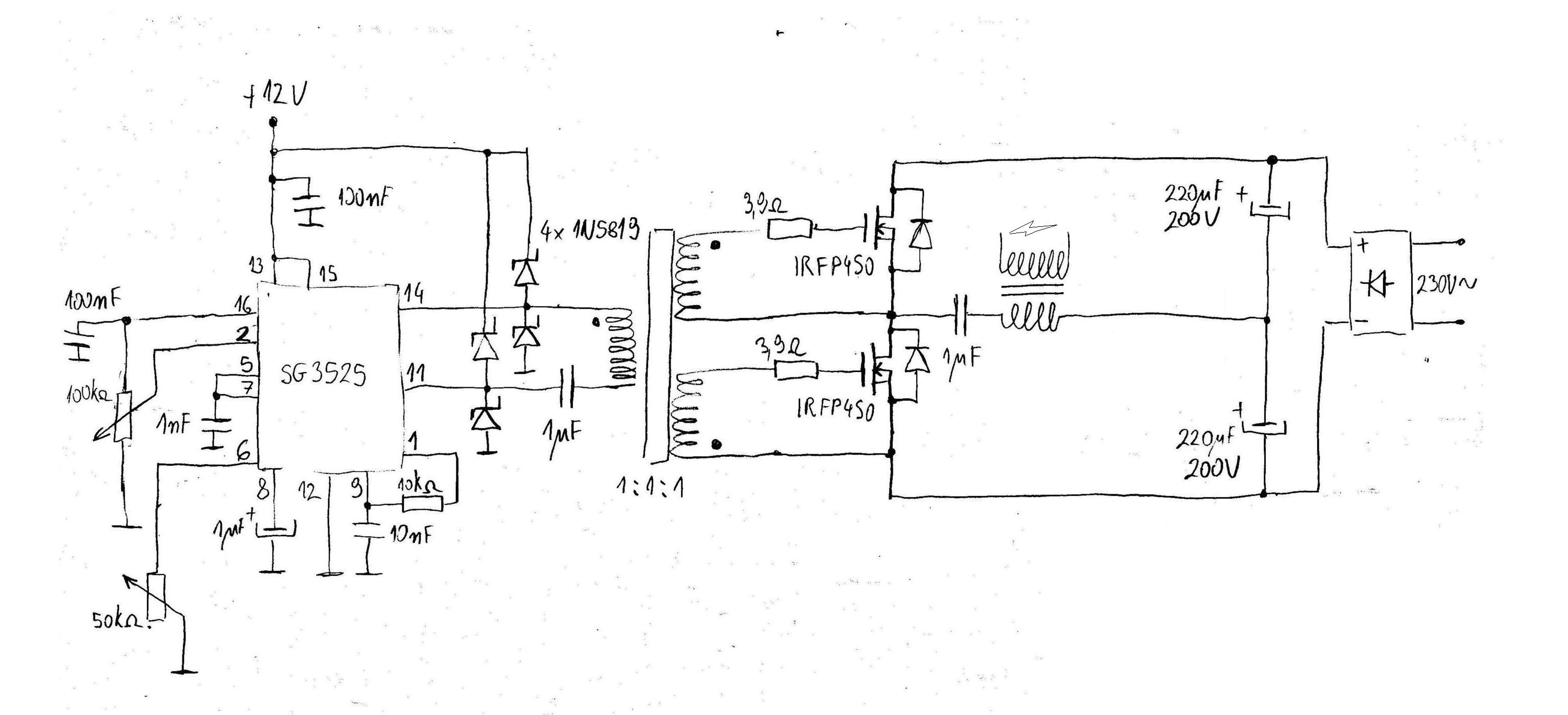

Connected to what value resistor ? I used a voltage divder but I guess at the values.
Connected to a similar circuit described above, like the one in this drawing Link2 remembering pin 9 on the drawing is pin 3 on your IC.

like this ?
1452287278 2431 FT174221 New
EDIT: Wooooooooooooooooooooooooooooooooooooooooooooooooo ooo yeah
Ive got it working, I put 10k ohms where Hen918 suggested.
4.6uS @ 5.1 volts
14.4uS @ 2.8 volts
Vref = 5.1 volts
It does vary linearly with the turn of the potentiometer. Now I need to pick some exact values, and really get the design formalized for a new etch.

EDIT: It appears when I put 1.3 volts on pin 9 ( ILM/SD ) the PWM pins, both drop to zero. so I guess I don't know what "pulse-by-pulse current limiting" means.
Edit : ill be using the IGBT :
]hgtg7n60a4d.pdf[/file] and switching 170 Vdc through the primary, at no more than 4 amps.

The control loop of the current limiting is causing it to drop the pwm to 0: When you apply over one volt, the controller drops the pwm, and keeps dropping it until the current voltage goes below 1 volt. If you are keeping the voltage at 1.3V, the controller will rapidly drop the pulse width all the way to zero until the over current voltage is dropped.

Hmmmmh. IGBT @ 170V ?
Supose your 4A is the peak current. If the current was rectangular then you IGBT will have Vcesat(4A)=1.8V. What loss in a Mosfet equates to 450mOhm Rsdon. This is quite bad.
If you assume a triangular current waveform the Mosfet is even better due to quadratic dependence on the current instead of nearly linear like the IGBT.
Looking at Digikey, Searching for Single Mosfets, "Vds>200V", "Ids>6A", "Rsdon < 400mOhm" and "THT" then entering the quantity of "1" and sorting for price you get a variety of alternatives that seem so much more suited for your project.....

I figured someone would say this. smile I just used the 7 amp and 30 amp versions since I have 30 of one and 40 of the other. there is a really good MOSFET I used at 30 volts and less. Which eventually this power supply will work off of at 12-18 volts input at 20+ amps.
EDIT: The voltage varies linearly from 0 - 0.7 after .7 it jumps to 1.25 V. below the .7 the PWM is off entirely. above the 1.25 its on.
I also have to keep the pin 9 below 5 volts or it will blow out.
