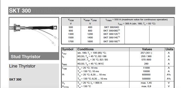

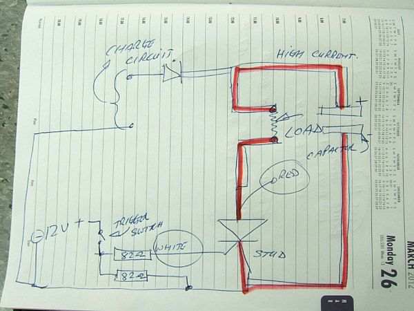

I've decided to use a different method of switching my ignition coil rather than having it in series with the flash capacitor since that killed my flash the last time.
I have this SCR sitting in the cupboard waiting to be used and am thinking of using it to dump a capacitor through an ignition coil for my trigger spark.
[As far as I know every image I have posted has been 600 wide so if there is an issue with these images as well please let me know why]
ADSC 2166 Zpskpbdwfcd
This is a clip of the pdf I was sent when I bought it.
20am Zpsvsavwaxx
This is the wiring diagram of the previous SCR I used but was warned that it may not switch the same way around with this other one.

This is what I saved more than a year ago when I bought it off someone: "
They are similar but in this model the stud is the anode so it will be live so beware of that. The white lead should be the gate if I remember correctly, the other lead is not required for triggering but I'm sure it is connected to the cathode so it means you don't have to run a lead to the crimp lug. First check the continuity between the cathode (crimp lug) and the red lead (and white) to confirm that. Use a low voltage non-inductive test load  to start with to check. If your circuit is using an 82.2Ohm resistor on the gate it would probably be better to go with something smaller because it likely won't switch. It will require more than 200mA for hard switching. Check the anode and cathode in reverse polarity too and make sure it's blocking.
I would also recommend putting a good fast switching diode across your coil to prolong the life of the capacitor and reduce stress on the SCR, ideally another antiparallel diode across the SCR and inline with the electrolytic capacitor would be better to but across the coil has the biggest impact and allows the current to keep flowing in the same direction and sap the rest of energy stored in the magnetic flux. I have destroyed countless components trying to defeat the forces of inductive voltage spikes! Generating 5 or 10kV and beyond is not difficult with a coil pulse so it's worth looking into at some point. "
Before I destroy it I was hoping that someone could advise me on the best switching circuit for it.
