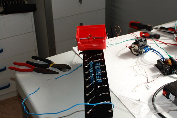

You might want to consider the following configuration. Notice the first capacitor in the Marx is not connected directly to ground, but through a charging element. It is grounded by the operation of a TSG (triggered spark gap). As the TSG has one main electrode grounded, the trigger source can also conveniently be grounded.
Because the Marx is triggered by grounding the first cap, it erects oppositely to the charging power supply. If this is a problem and you still want a +ve output, then the charging power supply can be inverted. As the spark is for photography, this should not be an issue.
Even though the Marx erects in the opposite polarity, the stray capacitances to ground still augment gap breakdown, and the remaining gaps fire promptly.

Interestingly I had also considered "adding a gap" before the capacitor array - but wondered if it was actually better for the 30kv trigger spark to be on the other side of one of the ballast resitors to prevent the charging system trying to jump the gap into the coil. But judging by the diagram you have drawn the trigger electrode is not central but rather closer to the 'earth' electrode of the spark gap[?] I suppose this guarantees the spark jumps in the right direction.
I will start building a spark gap switch. Thanks for the help, I wil have to 'refine' my last attempt at a spark gap switch with a central trigger :)

I've looked at your trigatron link. When the main voltage is <1000v, you can use whatever tight geometry you like, the electrons aren't going anywhere until the trigger gap fires. That design was OK for 325v, but it is not going to work for a Marx.
When the main voltage is >10kV, you need smooth electrodes. As the trigger electrode will be at the same potential as the ground main electrode, you need to make sure the hot electrode doesn't break down to the trigger spontanteously. This means the hot to trigger gap should be at least as large as the hot to ground gap. Even though the trigger electrode will tend to have a smaller radius than the main ground one, if it is close enough to it, it will tend to be shielded somewhat by its electric field. This all leads to a very offset trigger electrode. Do what I suggested and follow that link I gave you.

Does it need to be enclosed like that or will it be ok "out in the open"?

There is no benefit of enclosing it for this service. The Marx has other open gaps which will be noisy, let off nasty gasses etc so there will be little benefit to enclosing just the first one. In fact there's a benefit with a Marx to mounting all the gaps in proximity in a straight line so the UV from the first assists the other gaps to break down. In this case, I would simply build the Marx as a conventional Marx, with the modification to where the ground goes, and then dangle a trigger wire near to the ground electrode in the first gap. The point of the links was to show the assymetry of the trigger, and the smooth electrodes, not the plastic holder.

Ok thanks - I'm thinking of rearranging the construction now so that the spark gaps are all on top of the device and easier to work with - (maybe even a mirror at the end to reflect the UV light? :) I never knew it made so much difference). I'm always in so much hurry to get something working I need to slow myself down and make it sturdy and adjustable so I can fine tune it without using a glue gun :D

I went shopping this morning - should I use the small or larger size domes. [i]
1439601441 56316 FT172562 Aadsc 9505
I pulled it apart and reassembled it so the spark gaps could be on top. Just as a test I replaced the first spark gap with the bolts with rounded caps so I could find the right size gap I would need before it triggers. No matter how closely I adjusted them it would not fire with the rounded bolts - even if I put a screwdriver in the gap it just jumps from one to the other but does not trigger the main spark.
I disconnect it from the bolts and fit the original wire gap again and it fires perfectly?
Ignore the trigger screw from the side for now - it will be adjusted correctly when it is in use.
Update: I tried again, smaller gap than all the others - and if I leave it charging long enough waving a screwdriver between the contacts fires it!

Something else I was thinking about - in the diagram you have provided where we switch the earth I imagine it is very dependant on the size of the final spark gap[?]
The way I look at it if it is capable of jmuping a 10cm gap and we try to trigger an earth gap then the earth gap will have to be an exact size to complete the main gap - otherwise that voltage will esily find its way across that gap and around resistors if it is suddenly reduced to 5cm or something similar.
Marxtriggerearth Zpsoxswrvsi
I had several successful triggers using the first spark gap. I set my camera up and tried a few more but before I could get a photo of it my old camera flash started smelling bad so I think its circuit got fried.
