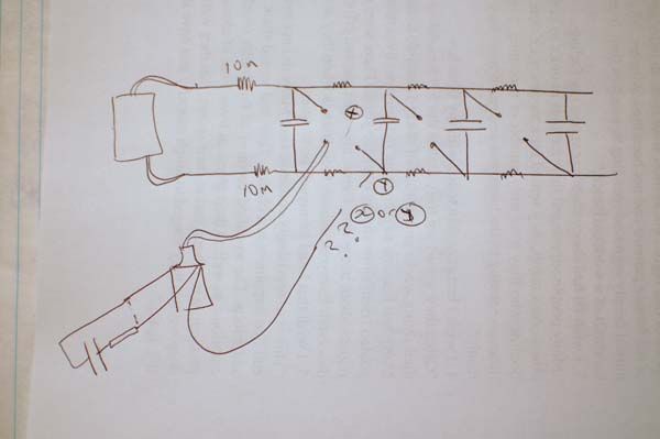

For ionization to occur there has to actually be a spark as a result - true? I mean I couldn't simply set up my circuit and have the HT lead from the coil in the middle without also having the earth of the spark system on the other side[?] or connected to the rest of the Marx generator circuit.
ALSO: Could I limit the voltage of my Marx generator to prevent it jumping around resistors to fire for example, by having a jacobs ladder at the beginning of the circuit and adjusting the gap at the base to control the voltage that charges the system?
So here's my new drawing. Where to place the earth wire of the spark trigger circuit? If it is across from the main HT lead will the ionization be too narrow for the system?
One more thought before I head off to get some sleep [night time in New Zealand] will it be safe to suberge the resistors in transformer oil to help insulate them?
ADSC 2160 Zps7pxvwyyy

With the schematic you have It looks like the ignition coil trigger circuit will have to be isolated and be able to withstand 30KV. Once the trigger gap fires the low side of the ignition coil will raise by 30KV relative to the Marx power supply low side. Assuming the bottom of the Marx power supply is low.
