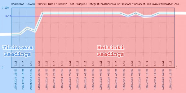

Hi Andre / all,
Well, the problem in my case was a missing capacitor, the so called "compensation capacitor". I presented all the details here: Link2
So it was a technical issue. Unless of cosmic provenience, I expect to see higher radiation readings as a gradually increasing curve.
On a different topic, 4 new stations went online, and with them the second case of higher natural background radiation, after Česká Čermná has been identified in Helsinki, Finland:
600x300
Full article here: Link2
My assumption is we are talking about higher uranium/thorium content in the soil. The network seems to do a good job at pinpointing those. I wonder how long until they will come after me. I also can't help to wonder how bad must it be for people to leave in such areas, where radon concentration must be higher as well.
