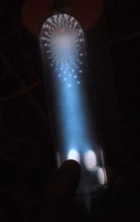

That tube is krypton-air mix (one of the early experiments), at pressures lower than I usually use for heavy gases. I've tried to replicate it later, but all new versions are of more blueish color, and the dots seem to move more rapidly.
Frequency is everywhere about 800 kHz, I usually test all plasmaballs on one single micro SSTC with known power input.

Hey, I made another such krypton tube, available on Ebay!

Those are really beautful!!! Why do you think the Krypton one has all those weird dots? Is it because of the nature of the gas, or due to the hv driver?

That seems to be a combo of krypton's own properties and the driver. Same dots in a weaker form can be seen from Ar and Xe. I've also seen a video where those dots appeared in a light sculpture of 10-20" large, and they were of green color. I wonder how that was done..
