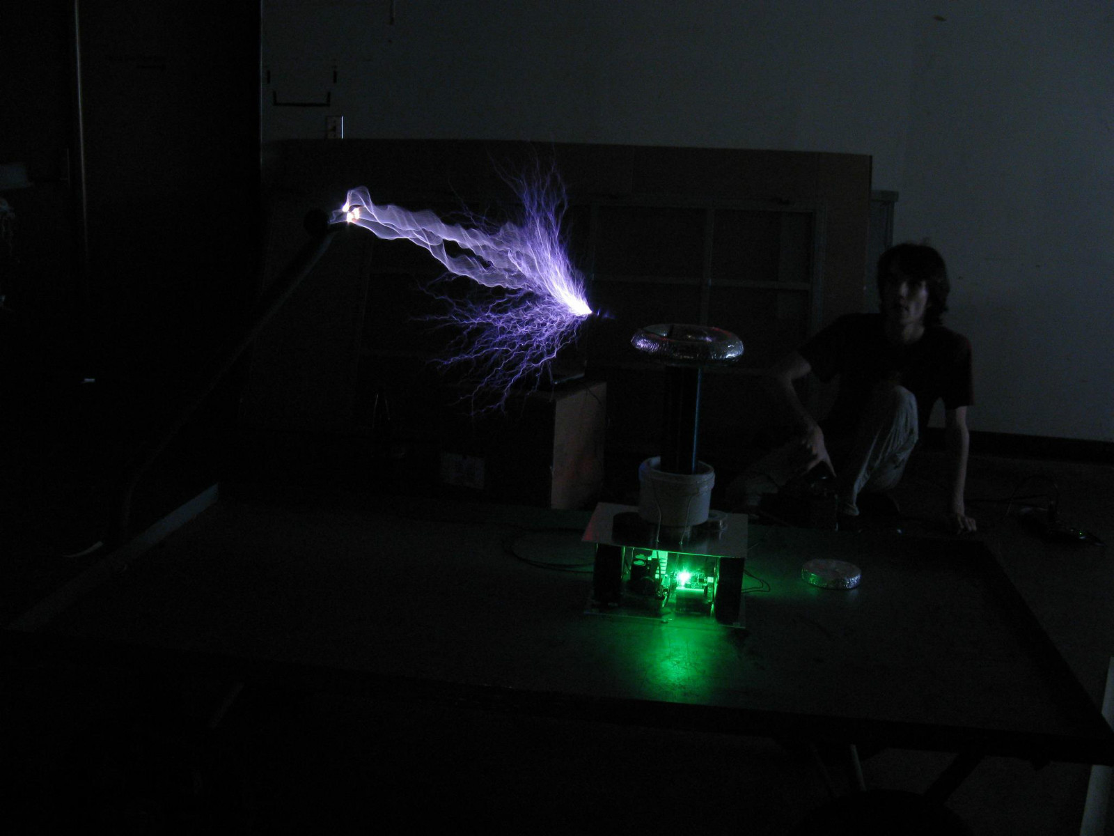

*Coil specs*
*~220KHz Fres
*2.5x10" secondary, 36 AWG with 2x8" topload
*Peak current: 350A
*Max spark length (ground strikes): 23"
*400VDC doubled variac feeding a half-bridge of FGH60N60SMD's
*14AWG primary, 6 turns on 3.5" former, 68 nF 3KV CDE940 series tank cap

Inspired by EVR's microBrute, I decided to route a DRSSTC onto a 4"x6" board.
The result:
Half the credit for this project goes to Daniel Kramnik, who built the coil in the video above using his revision of my design (which includes an optical interrupter).
The driver:
29 650
Low-power (~50W) sparks:
Ntesla
Critical coil specs:
Driver: half-bridge of FGH60N60SMD IGBT's
Primary: 4.5 turns of 14 AWG on a 3.5" PVC former
Secondary: 2.5x7", 36 AWG with a 2x7" topload. Resonant frequency is ~320KHz
Tank cap: CDE940C30S68K-F, 0.068 uF@3KV
The video is running at 250A with 30uS on time and 340V bus voltage.
Power figures:
4"@30W, 5uS on
6"@80W, 20uS on
10"@140W, 30uS on
(all numbers at 200 bps)
Blog post about it here: Link2
Board file for the (old) version of the coil: Link2
Digikey BOM for everything except the transistors: Link2

thats pretty awesome. how long of a streamer can you get in free air? what does the interrupter look like? is over current protection not needed in little coils?
Dr. ISOTOP
Tue Jun 12 2012, 03:05PM
Dr. ISOTOP Registered Member #2919 Joined: Fri Jun 11 2010, 06:30PM
Location: Cambridge, MA
Posts: 652
lightlinked wrote ...
I can get 6-7" in free air; note that the entire coil floats, so this may be limiting my streamer performance.
The interrupter is microcontroller with optocoupled output.
I've yet to need OCD on this coil. The bridge seems to hold up fine during ground strikes.

if you ground it you not only will get longer streamers, but the audio will stop crackling too. that's because the crackling is caused by the streamer having trouble breaking out. notice how you get perfect audio quality when you get "ground" strikes.

Excellent IGBT choice smile. I say this because i use that part for some other projects of mine and im very happy with them.
Have you reached a point of part failure? or have you simply limited the on-time and current to be "safe"? I suppose your single MMC cap can only take so much as well.
Maybe also consider using 2 separate heatsinks so that you can directly mount the IGBTs and avoid thermal resistance of an insulator. At least i'd look at that for maximizing the performance of those parts.
Very nice work, either way.

I've yet to reach IGBT failure on the 60N60's; on the old bridge (FGH40N60SMDF) it would silently die at about 300A. Been meaning to push the coil to the point of destruction, but I'm out of 60N60's for now tongue a few transistors gave their lives due to human error.
Here's a new video with streamers; tying the secondary base to earth ground worked wonders. I also added a low-pass filter (R and C in parallel to ground) on the feedback pin on the 7414, which got rid of the static-ish noise in the first video.

Bwang sent out a double-sided version of the board - all noise issues are long gone, and the performance is even better with longer on-times and looser coupling.
Specs. are ~2 feet spark length with 300 - 350A primary current at 400Vbus and a 2.5" x 10" secondary.
