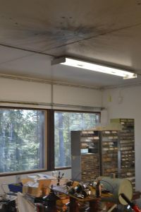

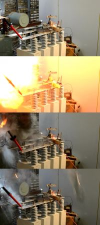

Yeah.. i have no idea what happened. May have been flashover or cap failure (or both) in charging doubler. Thats why you should always have large charging resistor in series with cap bank (after this accident i have been using 1 meter long 100kOhm water resistor.)
No one was hurt but i got hit by nice fire ball and blast of charred capacitor oil (STINKS). Thankfully i had full face shield and hearing protection.
Two microwave caps hit ceiling so hard their endcaps and terminals had to be pulled from plywood with pliers cheesey
