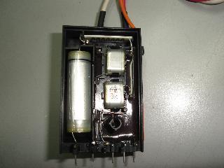

Yah Mary, same deal with my schematic, it only had connections for the 10 horseshoe pins, but i found this picture where you can see the inside:
20capacitor
It's not a picture of my model, but still helps give some understanding.

Captain Proton wrote ...
20capacitor
What is the silver cylinder thingie?
Ash Small
Sat Nov 19 2011, 10:35AM
Posts: 4245
Patrick wrote ...
Capacitor?
(I did read recently that monitor flybacks have capacitors, and TV flybacks don't)
