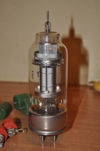

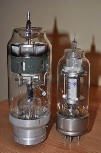

The TGi2-400/16 and the smaller TGi1-130/10 , I got them both as NOS, but the bigger one already shows signs of use from my first tests (thin metallic layer on the glass):
1318498472 1938 FT125954 Dsc 0161 1318498474 1938 FT125954 Dsc 0164
Both are hydrogen thyratrons.

Wed Jan 11 2012, 06:03PM
radhoo Registered Member #1938 Joined: Sun Jan 25 2009, 12:44PM
Location: Romania
Posts: 701
Some old news I didn't have the chance to post:
I did the change, and managed to get it working .
Strangely, the behavior of the tube changed while switching. I re-wired it in the old topology, and the behavior was consistent.
Apparently I kept it on for a longer time, and probably there was more hydrogen released.
The pink discharge was better placed now, spatially positioned just under the plate, as expected. Last time I did this (as in the video abovE), it was more diffused. I was unable to capture it on video, as the experiment was short lived:
Suddenly, the filament started to glow extremely bright. This happened before too, from time to time, but after cooling would get to normal functionality. Not this time. Also the reservoir secondary filament was too dim, so probably not much hydrogen produced either.
Keeping the filament on in this condition , resulted in metallic layers deposited on the glass, with shadows cast by internal components, where the path from the filament to the glass was obstructed.
I assume the tube is now damaged, but what happened? Did I switch too late to the topology Proud Mary suggested ?
Thu Jan 12 2012, 10:17AM
Metal vapour deposits on the glass indicate end stage failure - because the internal insulators will also have metal deposited on them.
The sort of fault condition you describe suggests you may have exceeded the maximum average power allowed for this device.
Maximum average power could be exceeded when
(1) anode voltage too high
(2) duty cycle too high
(3) pulses too long
(4) output impedance too low
(5) reservoir heater voltage too low (i.e. not enough hydrogen due to gas clean up)
(6) emissive material from the cathode has been deposited on the grid causing grid emission
(7) inverse voltage limit exceeded so reverse conduction occurs - known as "arc-back"
and so on, and so on.... cheesey

Proud Mary wrote ...
Maximum average power could be exceeded when:
NO (1) anode voltage too high
NO (2) duty cycle too high
MAYBE (3) pulses too long
MAYBE (4) output impedance too low
NO (5) reservoir heater voltage too low (i.e. not enough hydrogen due to gas clean up)
NO (6) emissive material from the cathode has been deposited on the grid causing grid emission
LIKELY (7) inverse voltage limit exceeded so reverse conduction occurs - known as "arc-back"
Looks like 7) is probably the cause of this problem, and also I'm not that sure my commanding signal was in the right parameters, since I adjusted it a lot during my tests.
So Steve, I will try the protection you've indicated for my next attempt. I do have replacements, but I'm not in a hurry to use them, not until I do my homework properly.
I must admit I'm surprised to see this tube is so "sensitive". My flyback power supply was not more than 200W, nothing compared to the RADAR installation where this tube was used.
Wed Jan 18 2012, 04:17PM
radhoo wrote ...
This little marvel is the famous 1258 miniature hydrogen thyratron and it stands just 52mm high. Its peak output power limit is 10kW, when it will draw a peak current of 20A - but its average current must not exceed 50mA - the figure we would use to calculate heat dissipation.
1326902127 543 FT0 1258
Its compact size made 1258 very popular in small marine and aircraft radar modulators - but if you ignore any of the absolute limits given in the data sheet of this or any other thyratron, it will fail quickly.
Many thyratrons have their own unique rules, so design from the data sheet is essential if disappointment is to be avoided.
