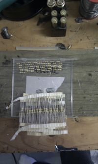

Trying to make a high voltage resistor out of a million 1/4W megohm resistors and some liquid electrical tape, because I'm cheap and got a ton of them "free" from uni.

4) No comment. High voltage resistors are useful :) I have 5000 x 390k VR37 resistors. If you are in .au and need some, I might be able to help.

4) You've sparked my curiosity, haha. But I'm anxious to see how my jury-rigged and thieved HV resistor holds up to the big NST :)
