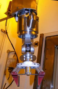

BTW, I was 'very' surprised to see that on the ISIS 800MeV proton accelerator at the Rutherford Appleton Laboratory they used a viton seal on the ~£25,000 several kilogram oxygen free copper tube that forms the end of the the accelerator where the beam enters the target station and hits the 'first' carbon target that produces pions which then decay to muons, before it hits the 'second' tantalum plated tungsten target that spallates neutrons. Presumably this is because this is one of two seals designed to be opened by the four robotic arms that will carry out maintenance, etc. for the next 20 years.
End of one of the arms:
1315255876 3414 FT123704 Arm 25
