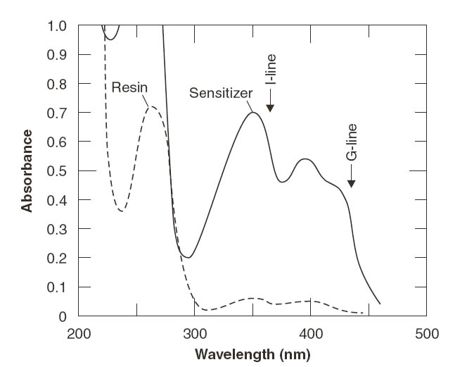

I recall common photoresist materials have their peak sensitivity in the near UV up to 400nm which greatly deminishes towards 450nm.
Novolak sensitivity: Link2 it seems that the sensitivity at 400nm is better than at 450nm by a factor of 3.

405nm diodes are dirt cheap, you might get better results with one of those, and not nearly as much power is needed.
