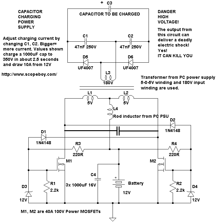

Personally, I would use a circuit based on the very popular "Mazzilli" flyback driver, often also called the ZVS flyback driver. It delivers more or less constant current, if I'm not mistaken, so it's ideal for capacitor charging, and it's simple, bulletproof and can deliver a lot of power. For 800V you could wind your own secondary on a suitable gapped ferrite core, this shouldn't be too much work.

Years ago, I made a really good capacitor charger using the transformer taken from an ATX PC power supply. These have a 160V primary, and a centre-tapped secondary to generate the 5 and 12V rails. I wired the secondary up as a Mazzilli oscillator using the centre tap and 5V taps, and fed the primary into a full-wave doubler with undersized capacitors to limit the charging current. (The Mazzilli oscillator gives a sine wave, so capacitors work fine as a ballast.)
It drew 10A @ 12V input and would charge 1500uF to 350V in a few seconds. For 800V, I guess you could put a 4-stage multiplier on the output.
The schematic is somewhere in the archives. I haven't been able to find it.
A capacitor charger can't be modelled as a RC circuit, because if it had a R, it would be 50% efficient.

Here it is Link2
Sat Jan 22 2011, 01:32PM
Thanks Anders! The circuit I was referring to is this one:
Charger2

@Steve McConner
Can the voltage be changed? By adding more diodes and caps for a full wave rectifier...
