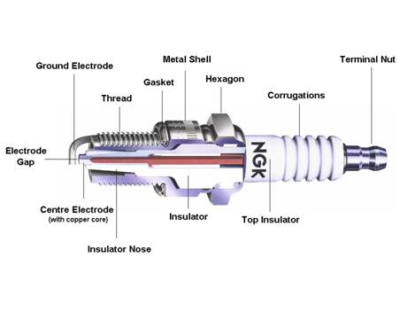

Why not use a car sparkplug connected to a steel chamber (with an opening for the barrel and one that matches the thread size)?
Ngksp
Of course, you would need to cut off the "ground electrode" and leave only the central electrode pin. The aluminum foil would contact the chamber and the central electrode. A much better choice I'd say considering these are actually designed both for sparks and high pressure.

Been there done that. Doesnt work. The inner metal part will get launched out from the insulator.
This is how i did mine: (insulation distances for 900V operation). Clear plastic disks are 3mm lexan. I have never had chamber failure with this ETG.
