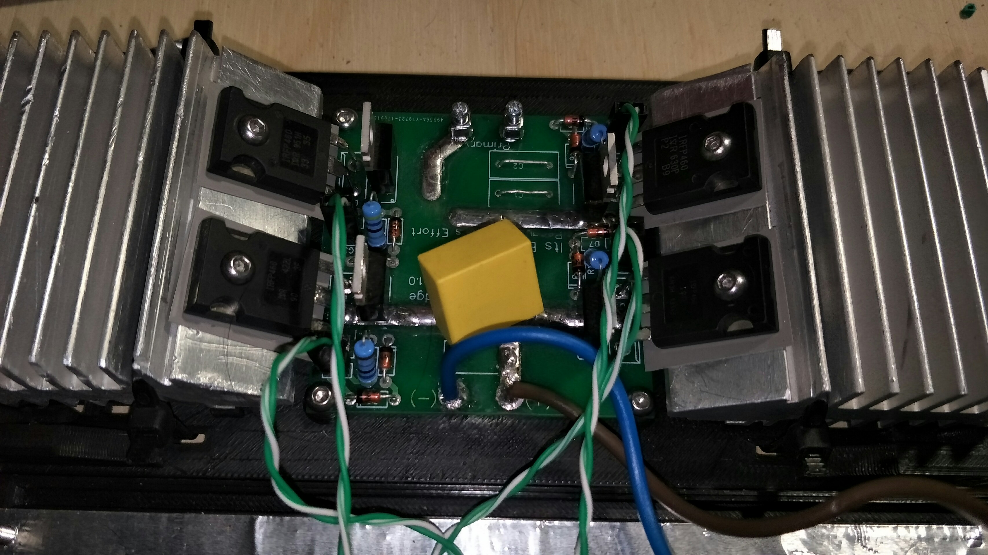

The bridge is a standard full bridge of IRFP460's based on kaiser's SSTC 2 design with the addition of zener protection diodes Link2

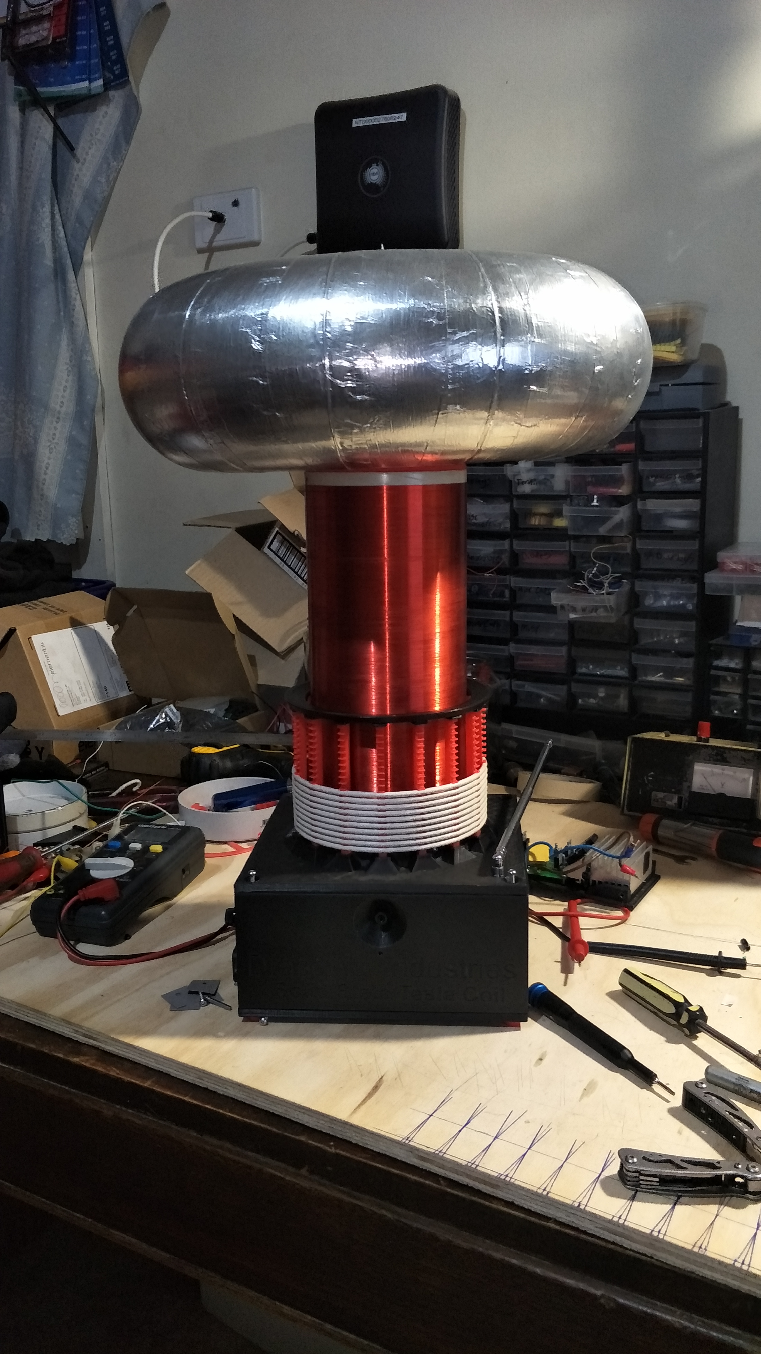

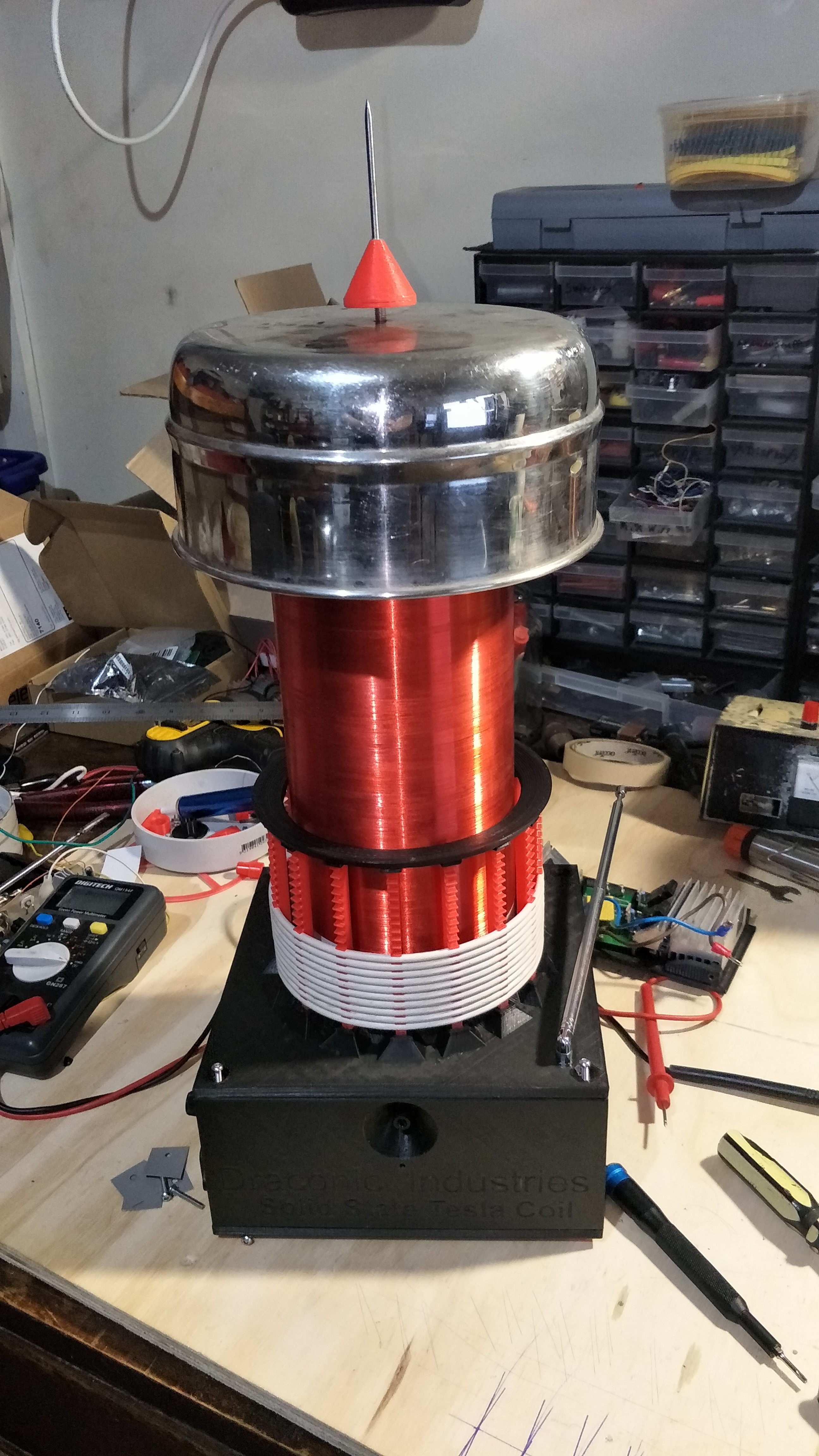

So here's where i get to my question. So far the coil has been performing flawlessly with a fairly small topload that i used to use on my old coils. But thats just an ugly stainless pot so for the new coil i decided to build a new topload.
But i think i may have goon a little big with the new topload because it seems to like eating fets. But the way in which the bride fails is rather unusual and i would like to figure out exactly whats going on before i write this off and build a new topload.

Hi paulj! Your correct in that the larger topload will lower the frequency but that shouldn't be a problem for an SSTC Generally they prefer a lower frequency because it means the fets dont have to switch as fast.
I think i read somewhere that high topload capacitance can lead to primary flash over though thats clearly not whats happening here.

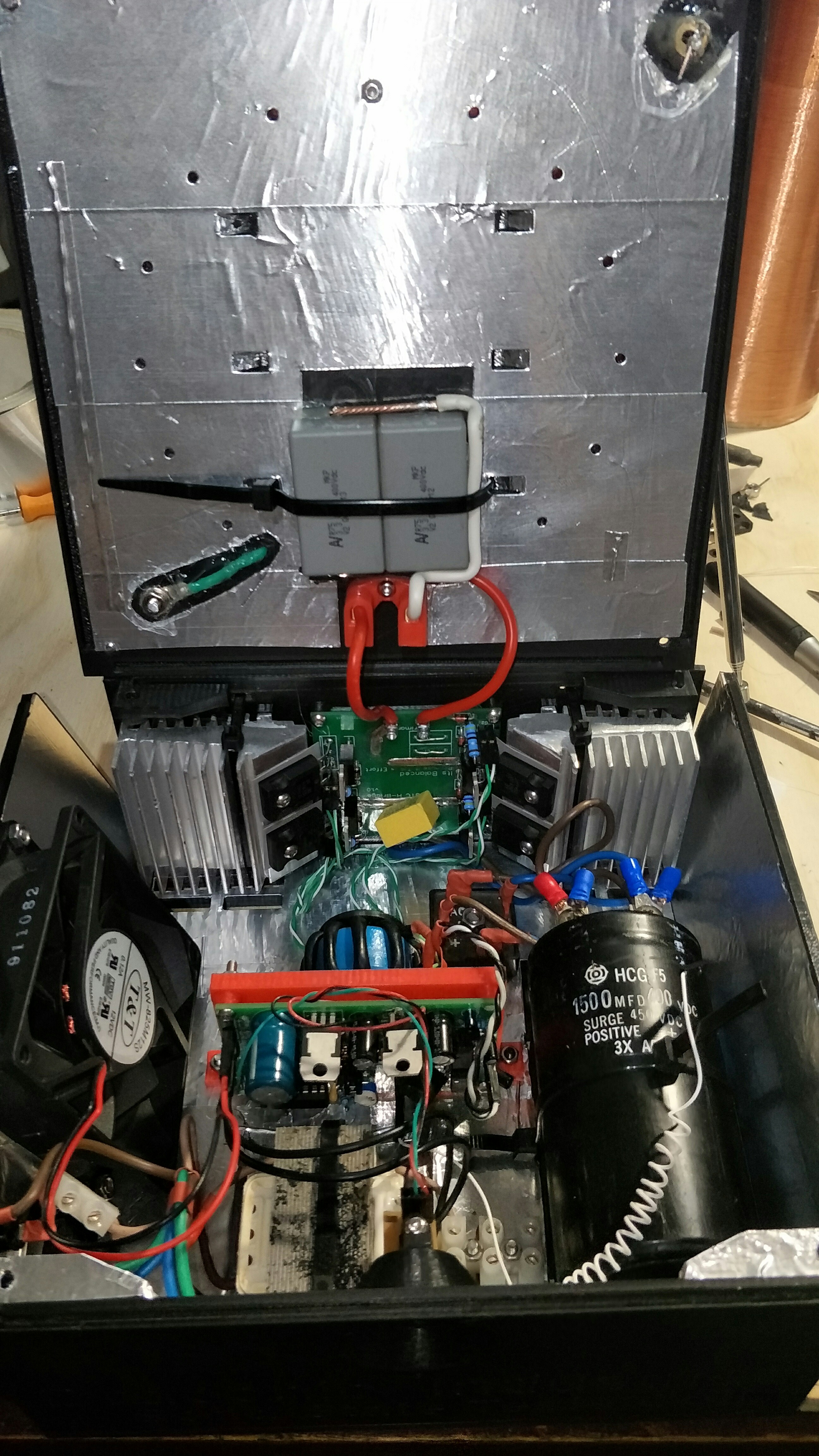

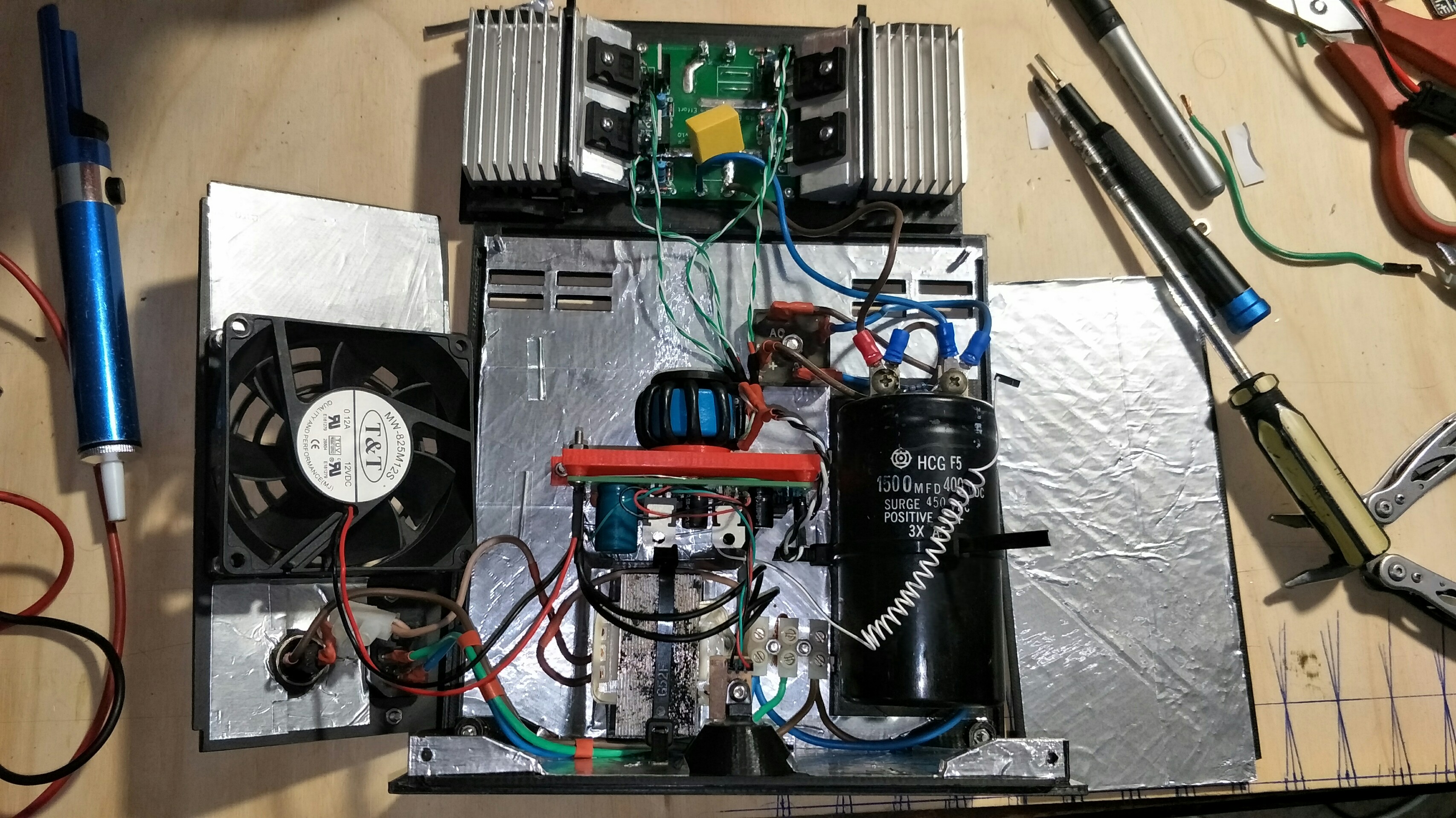

Before i log off for the night here are some pics of the internals.

If you mean the zener diodes i am using for gate protection. Interestingly they are fine when it fails in this way. Normally when the bridge fails it almost always blows the diodes that were protecting the failed fets but that does not seem to be the case with this failure mode.
I have a small 33nf snubber cap across the DC bus directly on the bridge but i dont have any tvs diodes on the fets. I just quickly tested the bridge after last nights failure and interestingly everything seems fine... I only tested the reverse diodes with my mm but usually when a fet dies the reverse diode also fails. I guess its possible a fet died open circuit and im just reading the MUR diode in parallel with it. I dont have time to properly debug the bridge rite now to i will look at it later today and let you know what i find out.

out of curiosity, how is the rectifier ?
after is possible that be a problem of parasitic inductance:
I note that the bus is connected far from the bridge and with small connections, can you try with a cable of larger section and shorter ?

Last nights failure was just caused by a dry solder joint on a fet gate (it was soldered on the back but i must have torn out the hole lining last time i changed that fet so it wasn't actually connected on the side that matters.)
So tonight i fixed that issue and beefed up/shortened the main lines from the tank cap to the bridge. Then i did some more testing and i think i can rule out the topload as the cause of my failures. I did two test runs tonight, both with the small topload and both ended in a blown bridge.
In both tests the coil ran flawlessly at high power levels but when i turn the interrupter pulse width down to minimal levels so that the coil is barely breaking out (around 1cm discharges) it kills the bridge within a matter of seconds. After the first failure i even tried grounding the bridge heat sinks (to mains ground) then tried again and again it worked fine at full power and died at low power... I really dont know whats going on here. Im hoping one of the sstc experts around here may have some experience with this type of issue.

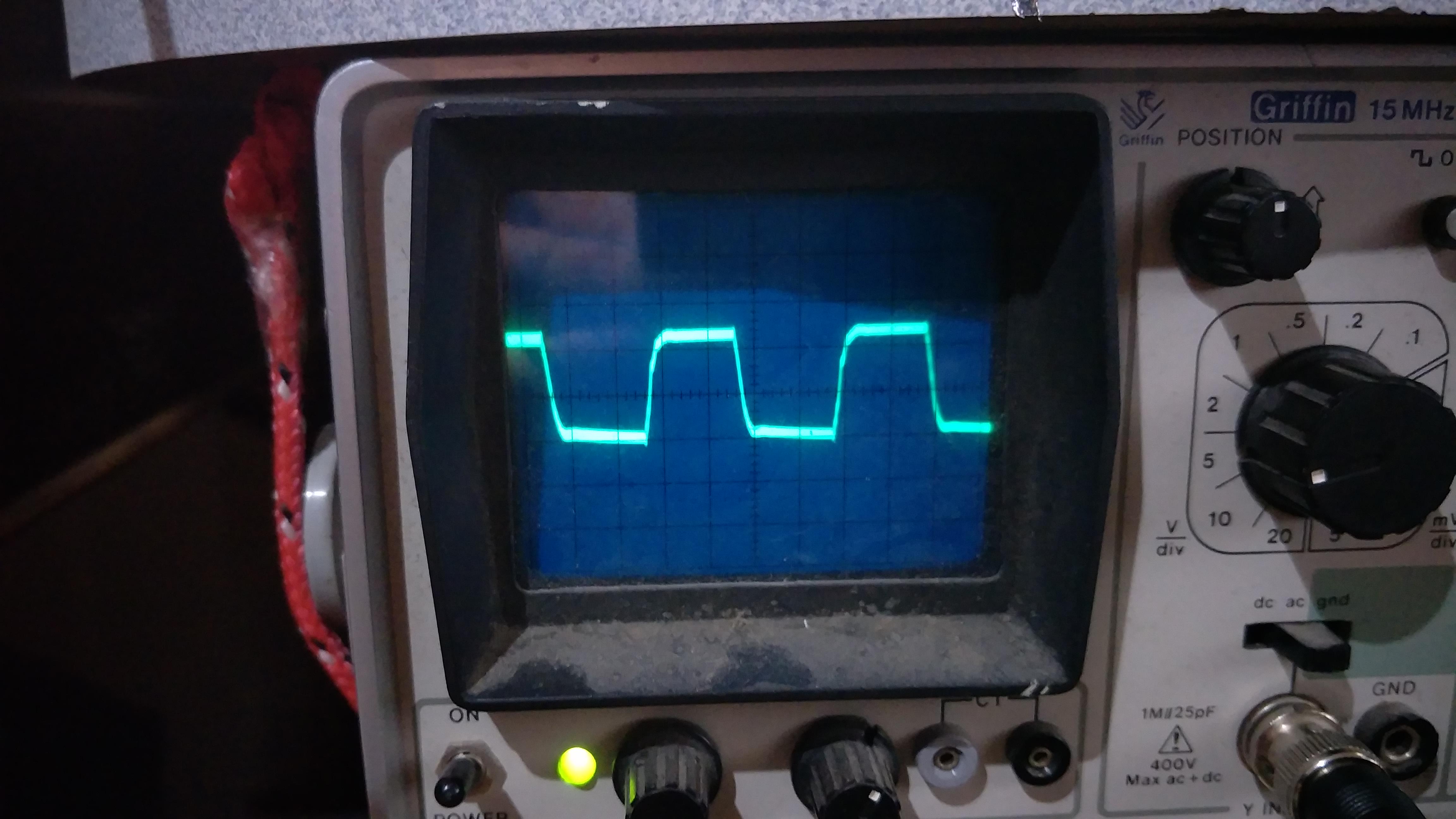

Edit2: Just in case anyone is wondering this is the drive signal at the gate of one of the fets when the driver is fed a 300KHz signal.
Clearly no issue there unless something is interfering with the drive signal when the coil is running.
Actually... it just occurred to me... assuming my scope is reading correctly thats a drive signal of only +- 5~ volts... When i disconnect the other 3 fets in gets closer to the expected +-12 and it looks like the drop is occurring on the driver side so i dont think its an issue withe the GDT. The drive voltage is only dropping to around 11~ volts so its not that... I will need to mess with this more later. Under-volting the gates could possibly result in the failure mode that i am seeing though im not sure how that ties into the only failing at low power part...
Edit3:
Ok so that may have been the result of a damaged UCC chip. I tried increasing the driver voltage to 15 volts (the max rated voltage of the drivers) and one of the drivers instantly blew with the GDT disconnected and before i even added a drive signal. The only possible cause i could think of at the time was that i had left the jumper wire i was using to supply the input signal free floating and it may have touched something it wasn't supposed to. So i replaced that chip and tried again and it worked fine with a drive voltage of around +-13 volts. But the drivers got way to hot so i decided to switch back to 12v reluctantly decided to try winding a new GDT but first i tested it again at 12v to make sure i didnt break anything and... it worked fine with a drive voltage around +-11 volts. So i suspect that driver that blew was already on its way out and the 15v supply just pushed it over the edge. So... i guess its time to test this thing again and see if it blows up.... again....

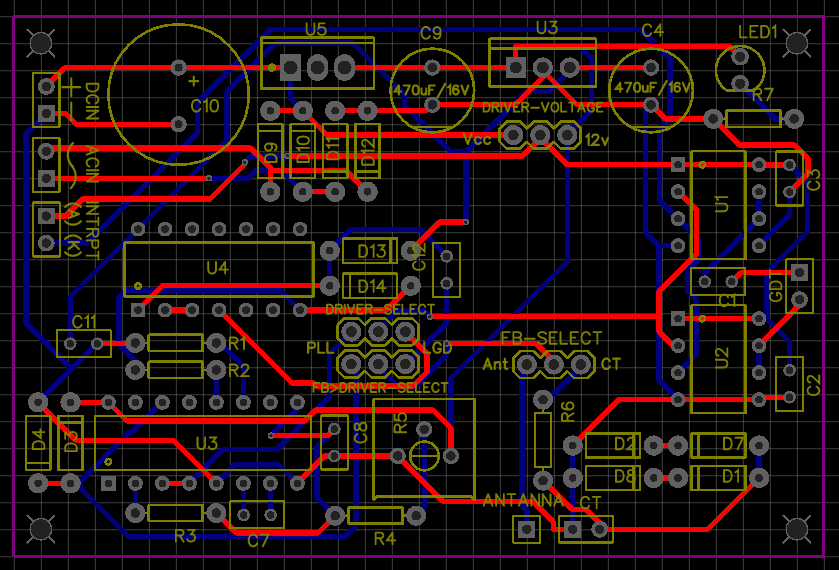

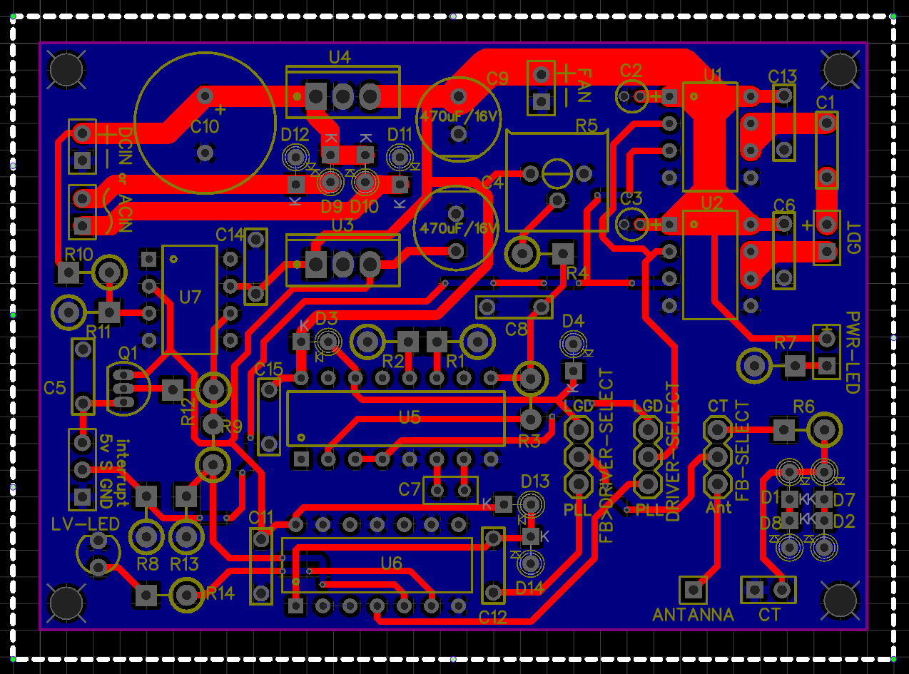

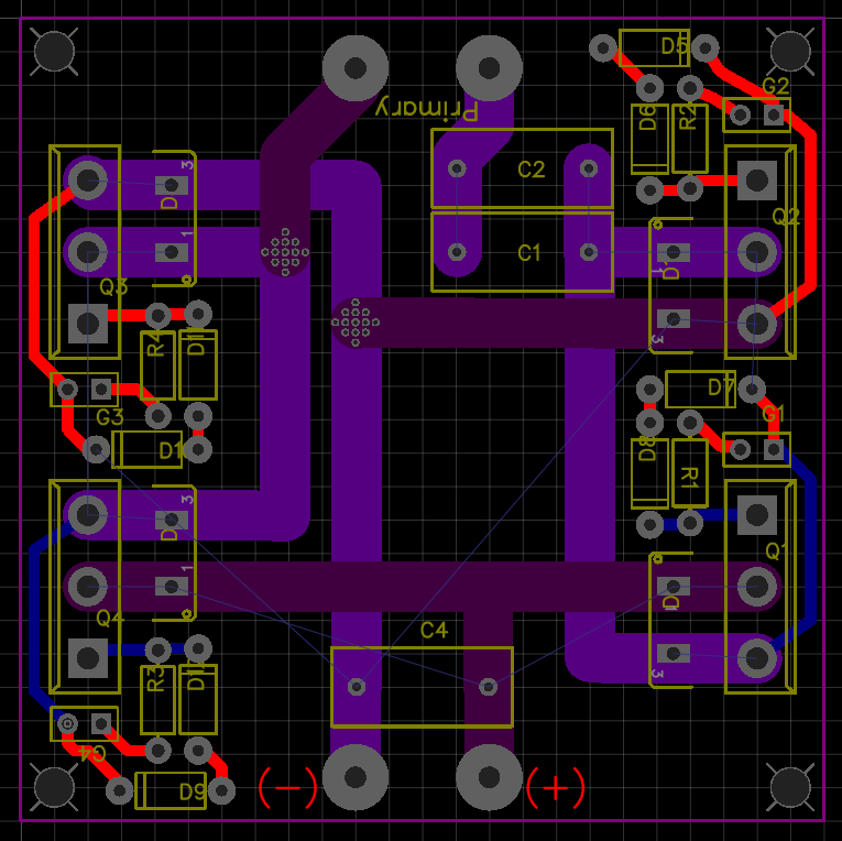

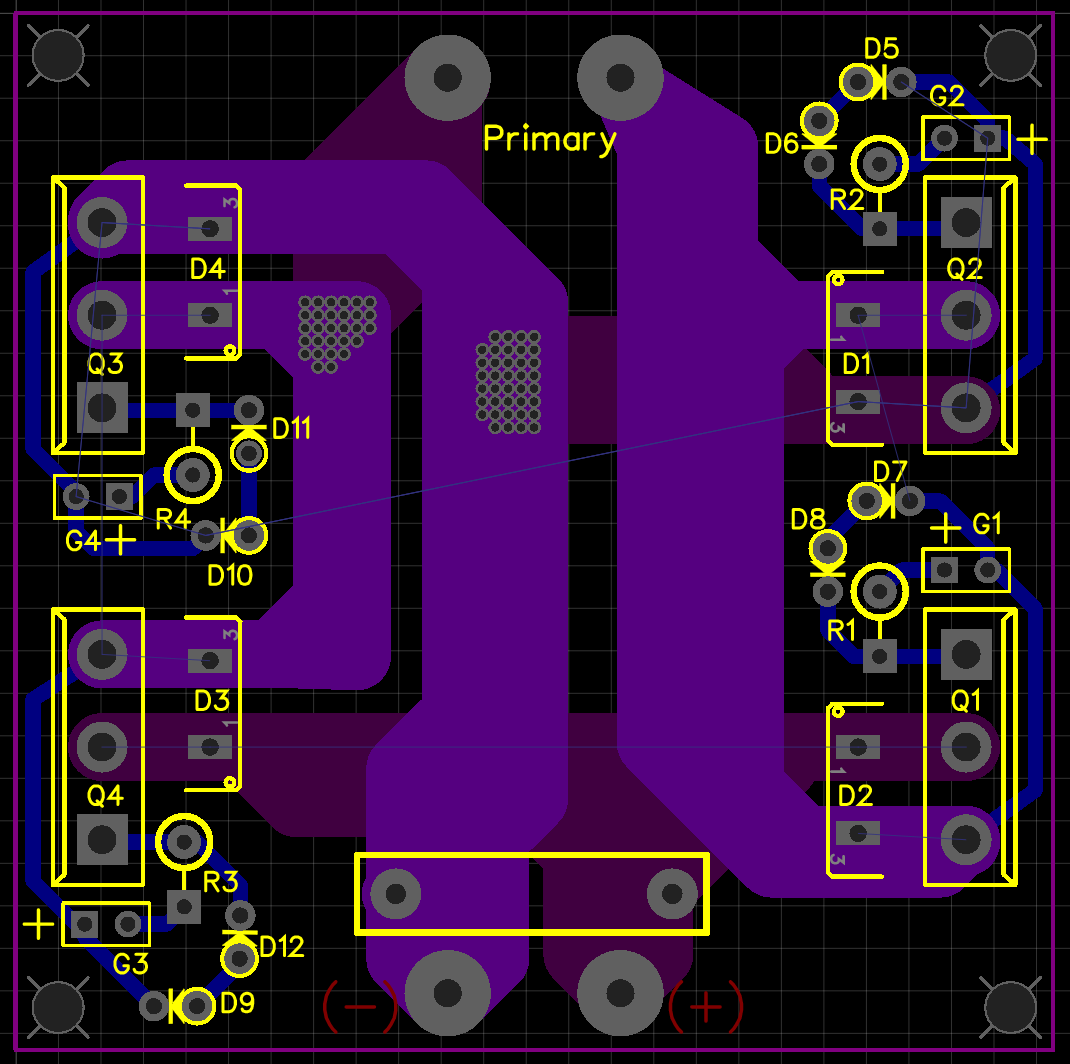

Haven't tested with the larger topload again yet but i have been beefing up the PCB's for the bridge final revisions.
Old H-Bridge
New H-Bridge
The tracks are completely unmasked so i can coat them with solder.
Old Driver (I had to do a very ugly hack to the power tracers just so it could handle the drive current)
New driver board (No auto-routing here!)
I also need to figure out a good small circuit to handle soft start.
